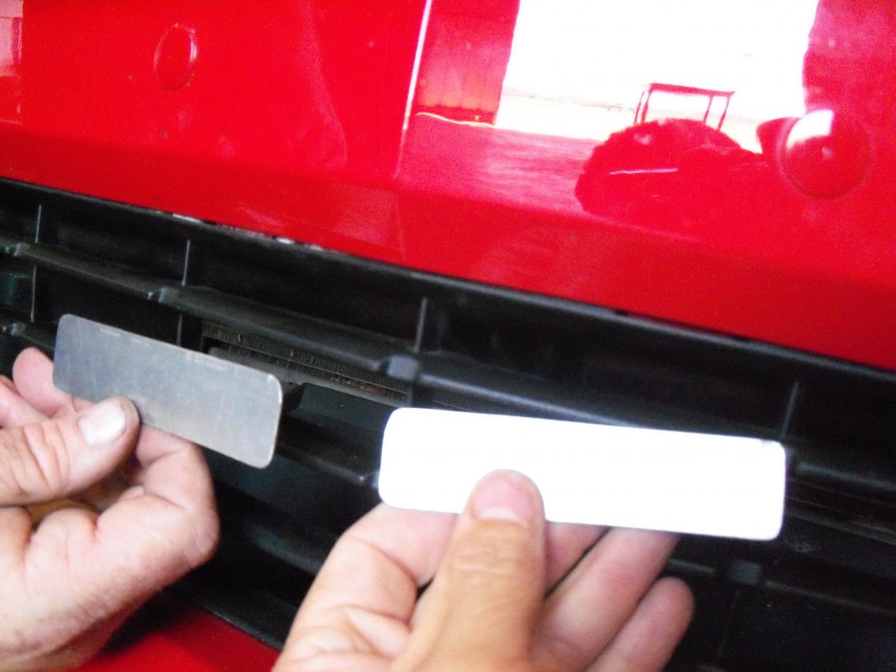

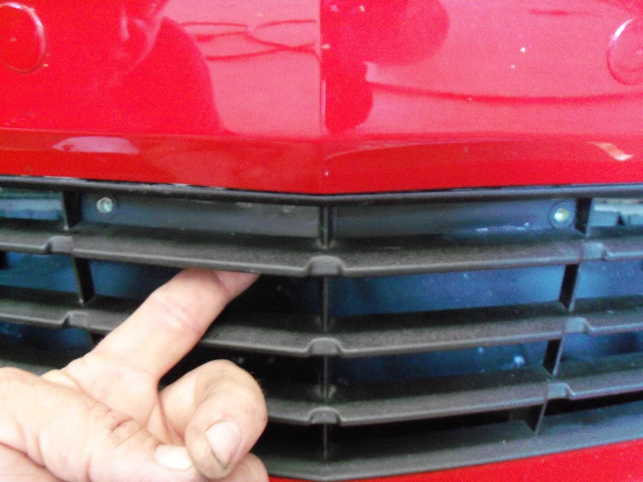

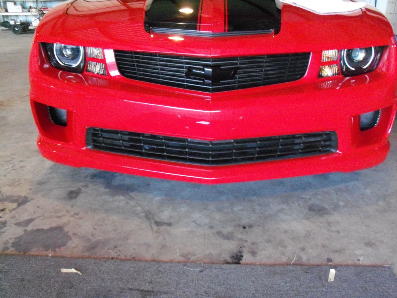

Hello, when i purchased my car, the front plate was already mounted, so i removed it a plugged them, looks better than the massive plate holder. so the other day i see it the news (san antonio) that they are cracking down on no front plates. So me and my buddy came up with this idea to make brackets so i could install and remove the plate when at car shows. turned out pretty good.
i used some aluminum, cut them to the size i needed, installed some riv-nuts in them and then epoxied them in. if you dont have riv-nuts you could maybe JB weld some nuts onto the plates.

your just full of good ideas!
how much did you have to trim off the bottom of the license plate?

thx bro. just below the license plate numbers. it really was trim fit, trim fit. also because of the bend made, it's cut in a slight "V", very slight though. it not just staight across. I will take the plate off tomorrow n take a closer pic n post it. I'm at the lake right now. lol

i went to a camaro gathering friday night and a car show yesterday, this mod worked out real well. off and back on in 20-30 seconds

Looks good, OP! What did you use to plug the holes?

Hello, I purchased some plastic plugs at pepboys. Painted them n pushed them in the bumper. Pretty easy.
