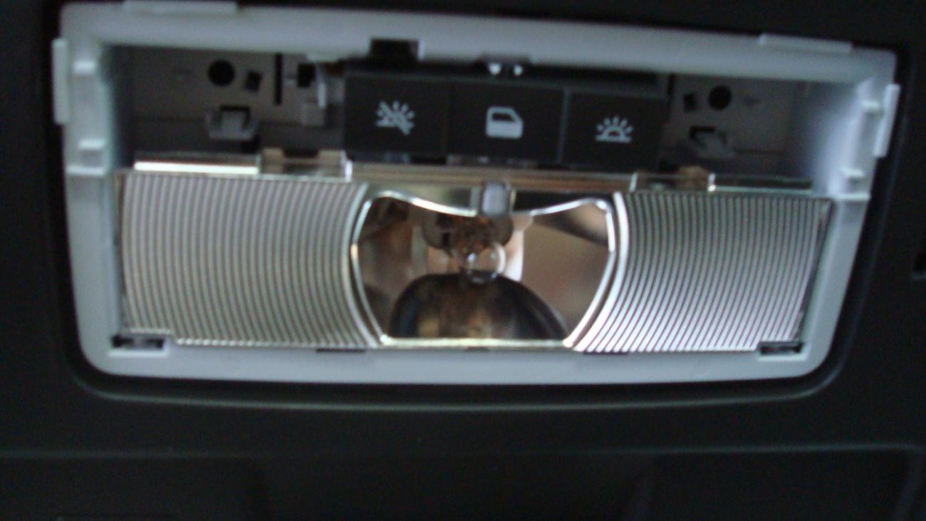

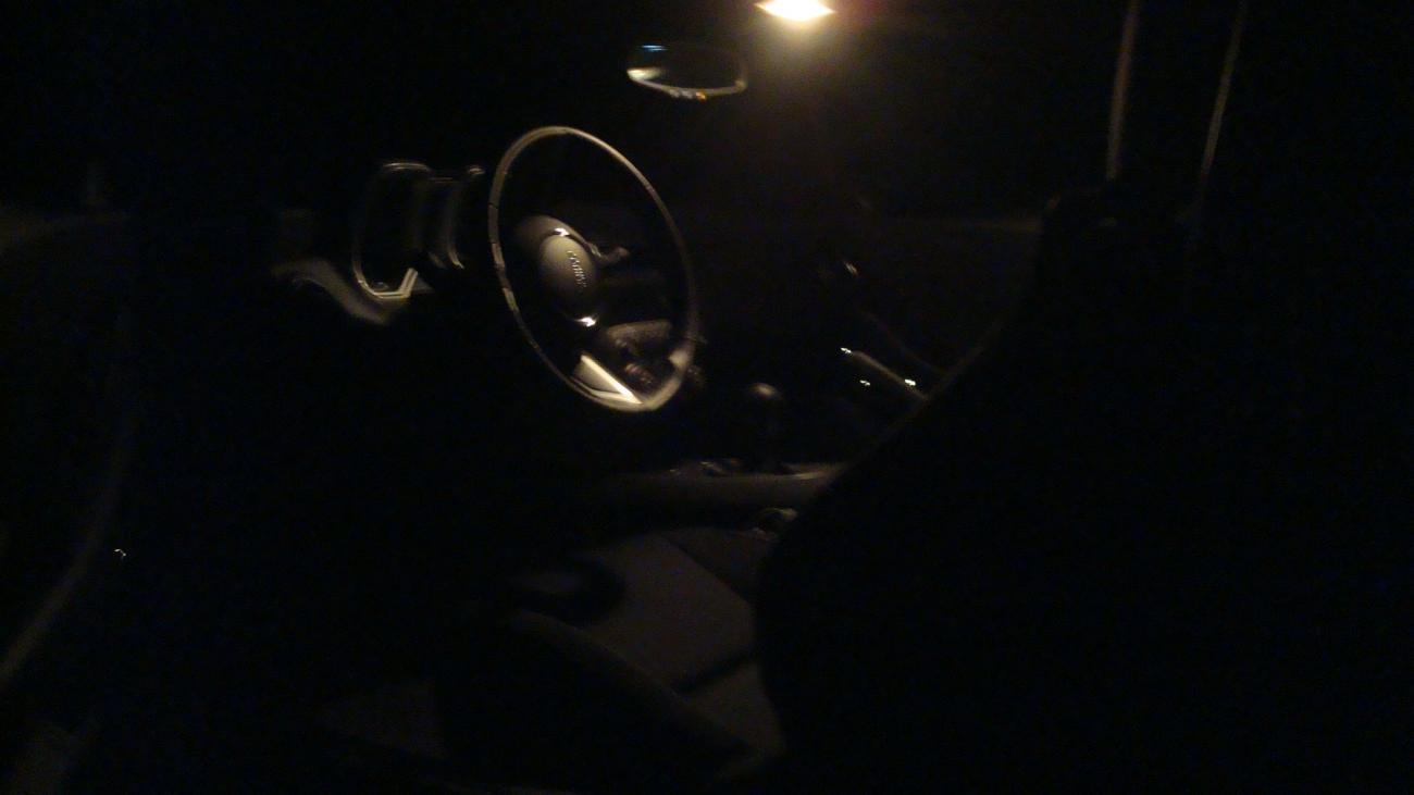

First the dome
Before
after

first remove the switch cover (i used a small flathead on the side and pop it out)

next remove the light cover
swap bulbs they pull right out and reverse steps to reinstall

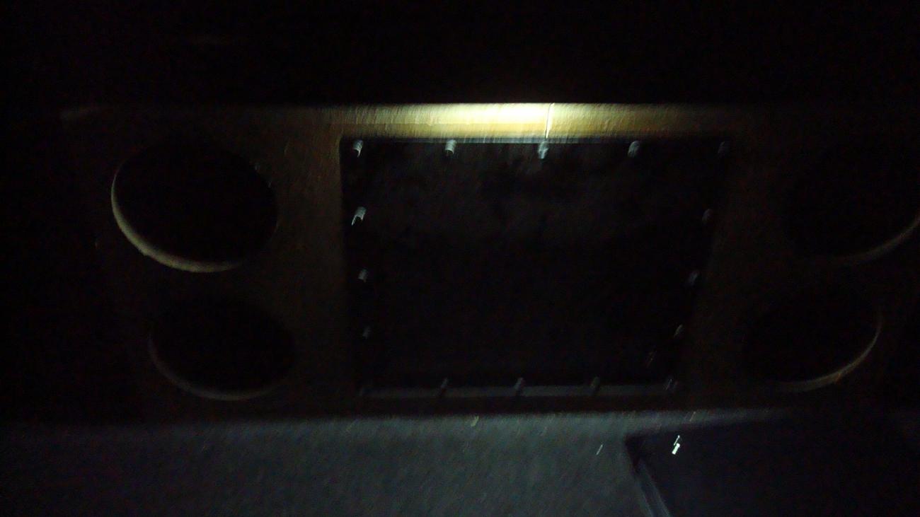

Now for the trunk
before
after

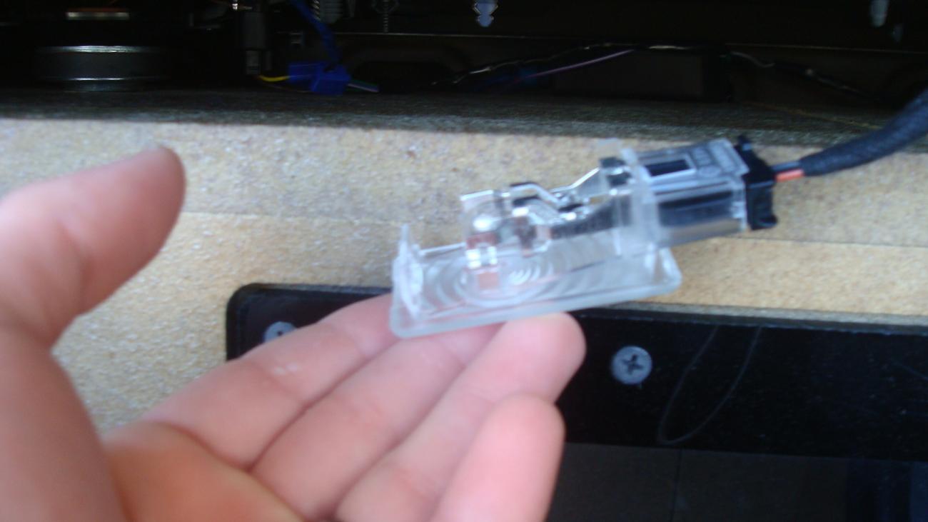

first carefully pry down on the driver side of the housing (i used the flathead again). slide down and out to the left
once out simply pull light out and replace
do in reverse to reinstall
Enjoy!
