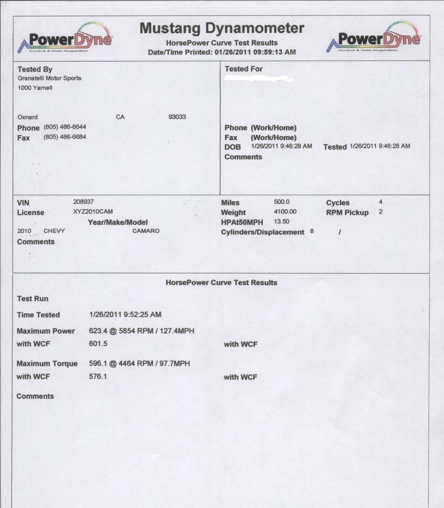

There is always room to grow but this “system” was basically intended to be a 1300hp system. If your goal is to go over that then there are many changes that I could see doing.
You do not NEED a boost controller unless you want to change boost real time while driving. We supply you with all the springs to go from 5 to 15psi. Simply put, a hand held tuner will not change boost – it needs to be done with a spring change or a boost controller.
The entire kit sits above the frame rail and nothing clanks or rubs.
Here is a dyno sheet from an auto trans car we just did -
Granatelli is offline   Reply With Quote

I think I would like the real time change just to tone it down on the street. I was thinking if possible to run a 3 psi spring and have a 6 psi max adjustable until I build the bottom end.
Now that I know there is no need to get larger turbos then I will be set....since I have no need for 1300+ HP.
