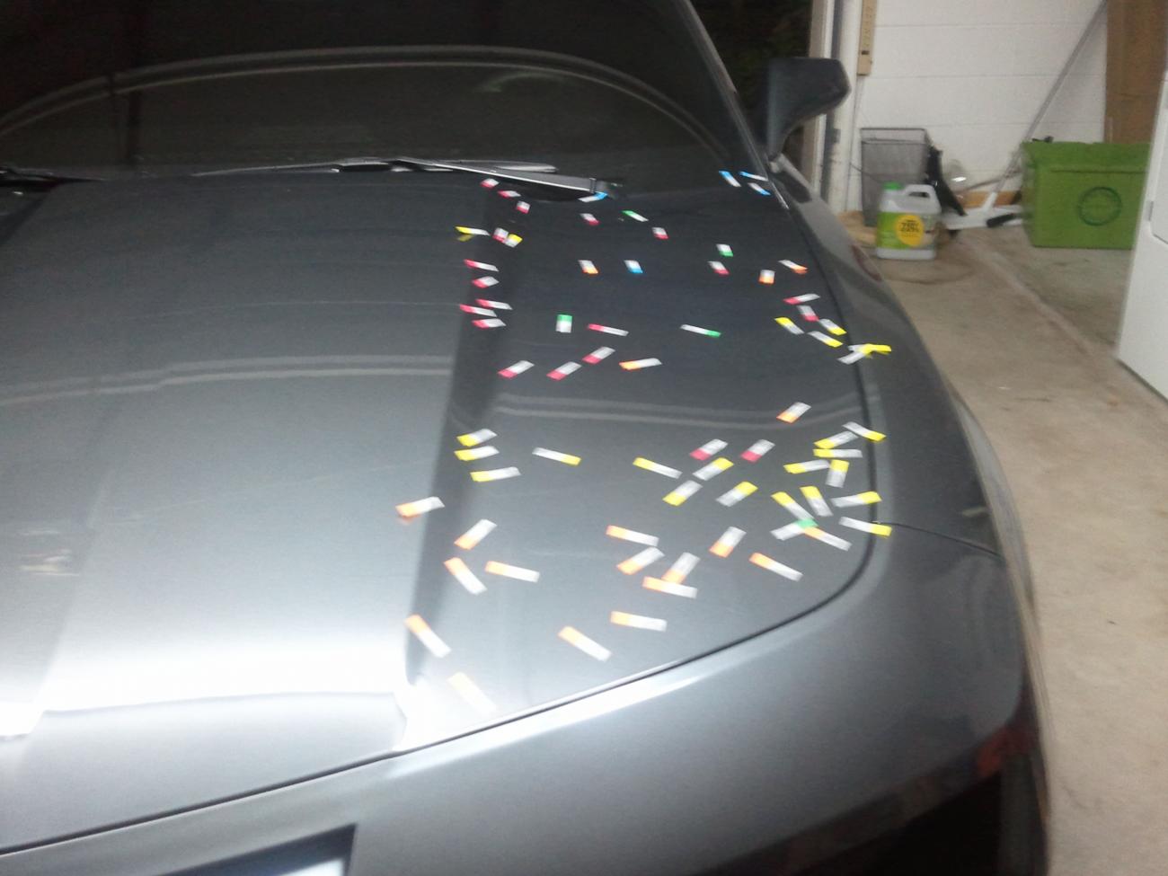

I'm not sure yet, I think a new plan might be in order? Here is a picture of my hood that was repainted under warranty. I decided to mark all the dirt/dust/blemish marks in the new paint with stickies....I ran out of stickies a quarter way through the process. They also never finished putting on the stripes. I'm upset with the whole thing, but I'm keeping my cool with it.
It sounds like they shot your car without using an airline filter. WOW B6 I think everyone in this forum is feeling for you right now bud! That just sucks. The upside is...you are an official pioneer in the "Make the Tremec Right" charge!
