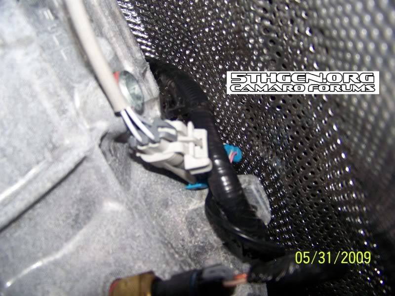

Hi, I just ordered a "skip shift" eliminator wire assembly. I have no idea where it goes, can somebody tell me? Thanks

http://www.slponline.com/inst/21008.pdf
INSTALLATION INSTRUCTIONS
1. Raise and secure vehicle high enough to access the transmission.
2. Carefully remove the connector from the skipshift solenoid.
(Skipshift solenoid is located about halfway down the transmission
case toward the top, on the drivers’ side.)
3. Install the white connector (see illustration) from the Skipshift Eliminator
Adaptor onto the skipshift solenoid/ (transmission end)
4. Install the original connector from the vehicle wiring harness into the other
Connector (see illustration) on the skipshift eliminator.
5. Place wiring harness back into original location, tucked up along the transmission.
If you can't shift into reverse after installing it then you plugged it into the wrong solenoid.
