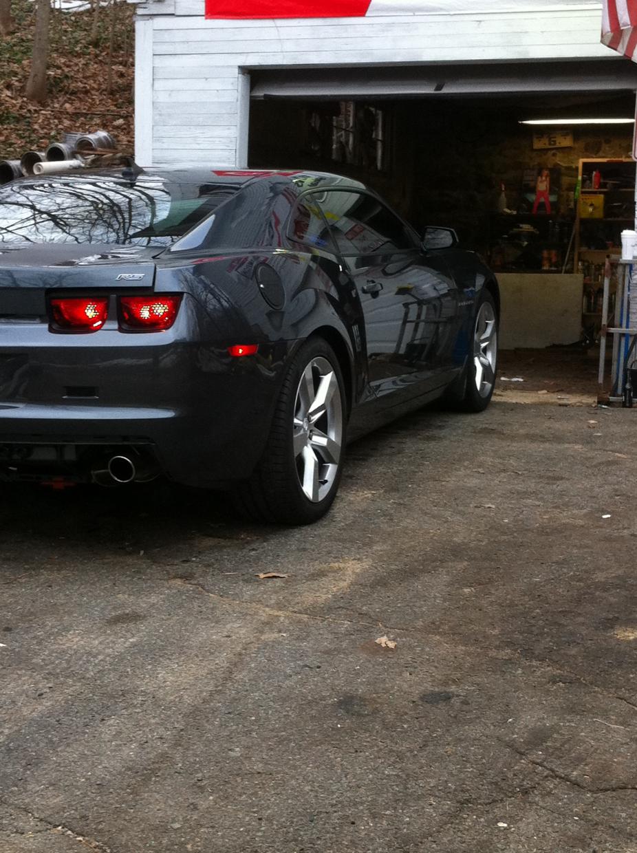

Ill make sher they do.I called a couple places and theye didnt know what i was talking about. but as they say the third time was a charm .the guy i talked too brout this up before i could ask.cant wait for this setup. Name:  iphone pics 227.jpg
