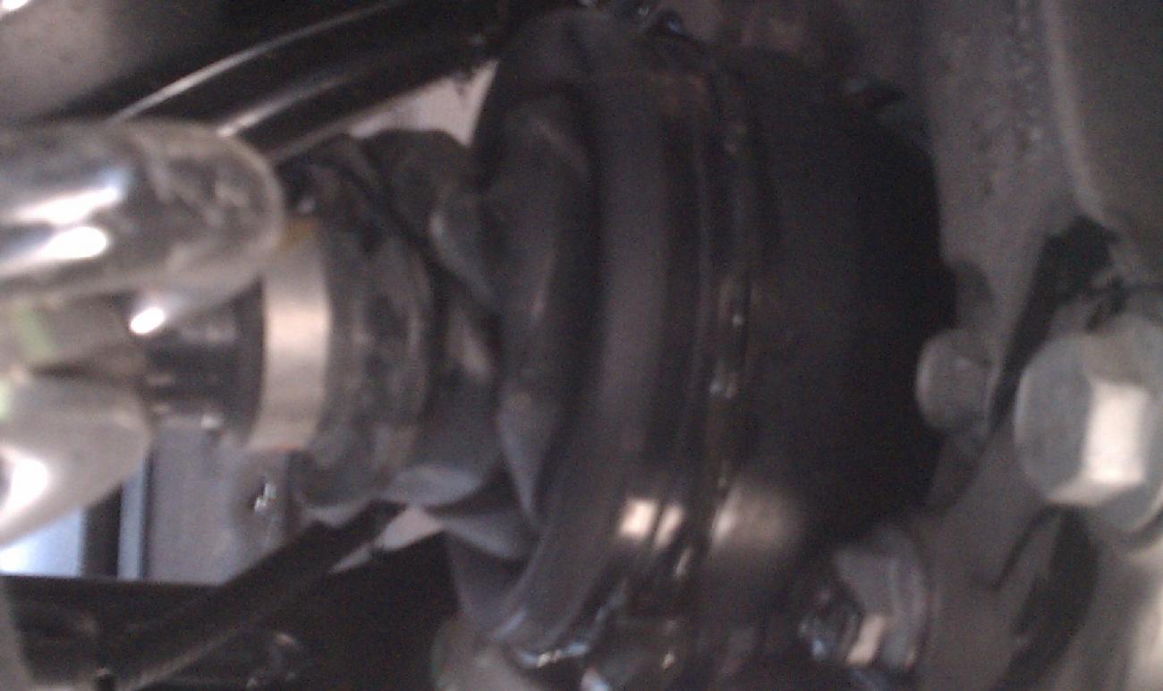

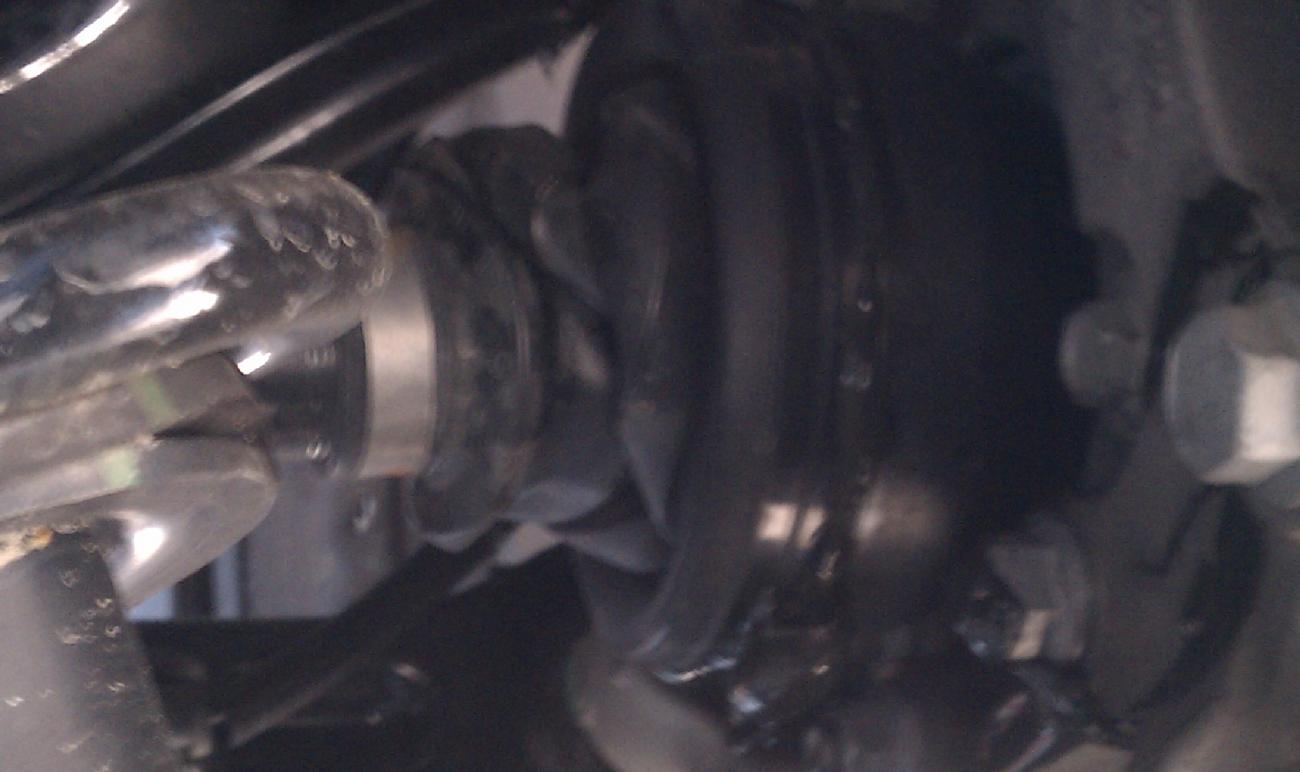

I haven't got her to the shop yet, due to army business but...I got under there a took a look and this is what I found...
Broken half shaft (I think its called) or Right output shaft...
Sorry for the blur
Hunt

Was there wheel-hop going on when you launched? The reason I ask is that I know in the IRS for the Cobra Mustangs the hop is what would kill the half shafts?

My 2 previous runs had real bad wheel hop...and the run where she broke, I didn't even get off the line.

I'll guess then it was probably the hop that did you in. It's a chronic problem with the stangs and I am sure it's the same with our Camaros. With my Cobra I could run drag radials and really air them down to 16-18 lbs this really helped with the hop issue. I haven't had a chance to run the Camaro at the strip yet, I'm hoping with the Nitto 555s aired way down I can launch with little hop. Most of the SVT guys suggested going with a soft sidewall slick to eliminate the hop completely.

Wheel hop will do it. A good set of rear sub frame and differential bushings, trailing arms, and toe rods will take care of it.

That's what I thought. Pretty common problem with people that truly run their cars and keep them stock. Time for heavy duty axles upgrade.
