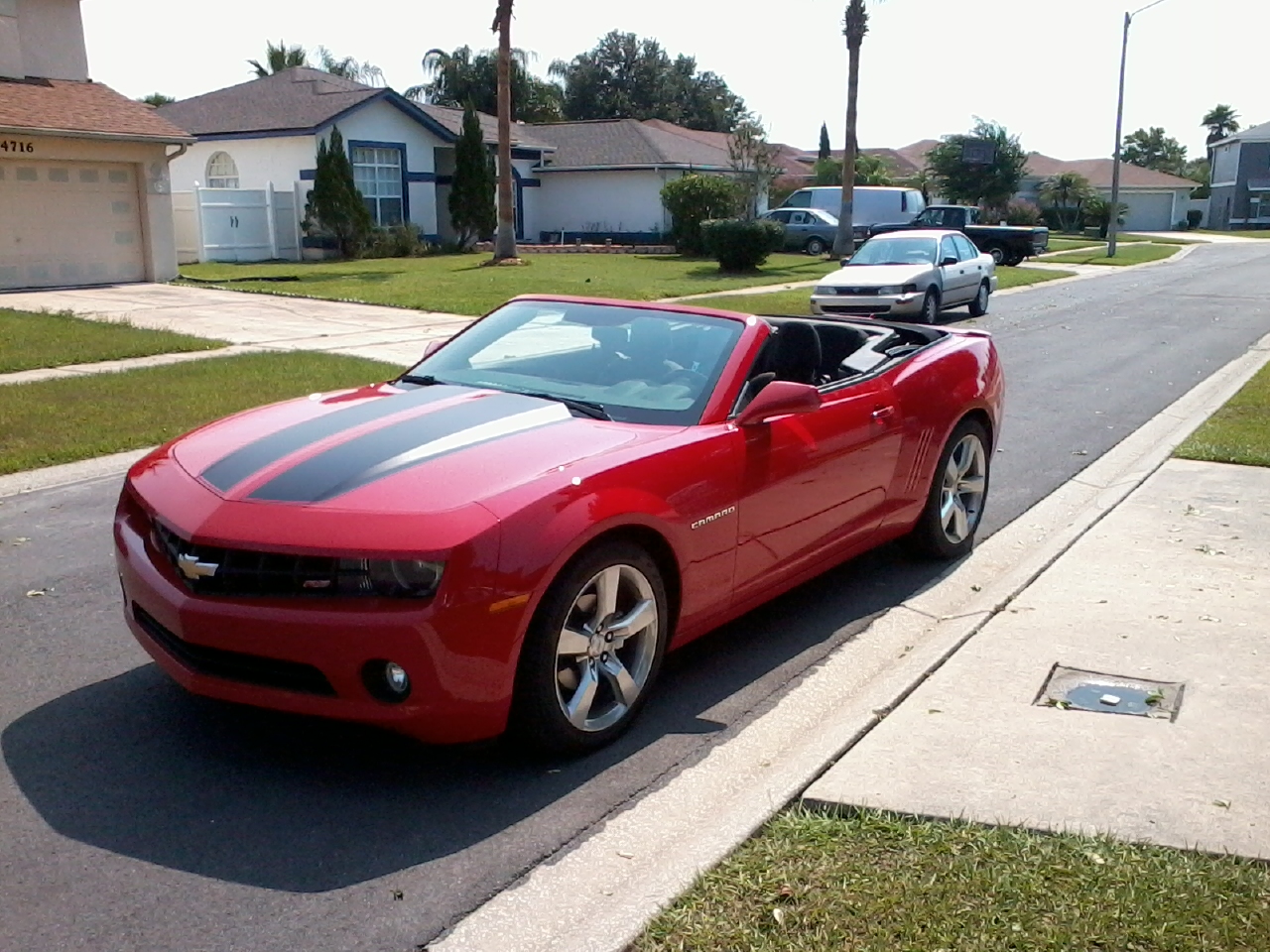

hi guys i bought my 2011 1LT RS convertible last night and love it
i do have a couple of questions
as i said i have the rs so i have the fog lamps and the owners manual says to push the headlight control to the left of the steering wheel (the circle you can turn left or right for automatic lights on/off etc) but the middle of the thing is solid the fog lamps work not sure if all the time i've only owned it since last night do they just come on when you drive or?
also any convertible owners when i stopped and turned off my car with the roof down then drove away again when i reached 8-10 mph a bell goes off with no indication as to what it is when i stopped and put my roof up it stopped and has not done it since (even after stopping/starting with the roof down again
appreciate any help

IIRC, the RS doesnt not have fog lamps, only DRL's. Mainly because HID's and halogens look odd together when both are on. So during the day, the lower lamps are on for safety, at night the top (HID's) lamps are on for visibility.
As for the bell, was the top all the way down? Could it have not been hitting the lower limit switch, so the car was yelling at you to not drive with the top in transit? My 4th gen vert had no such alarm (the top could be activated at any speed), but I could see how the new ones could.

no the roof was completely down i had driven maybe 10 miles no problem stopped got back in and the bells started only when you hit 8-10 mph and stopped after around 10 seconds but started again every time you went below 8 mph for stop signs/turns etc but then roof up no bells then i started and stopped with the roof down several more time this afternoon and there is no problem i'm hoping it was something like that the sensor for the roof being down just had a temporary glitch or something and it seems to just be that haven't had it again...yet lol

When you put the top down it has to get to the very bottom of it's cycle, otherwise it will think it's not all the way down yet. This happened to me last week, I couldn't pop the trunk because the top didn't think it was all the way down.
When you put the top down, push and hold the top down button, and the top motor should cut off when the top is all the way down and at the bottom of its cycle. Of course if you have already done this, please ignore.
