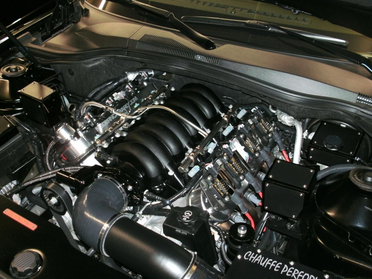

Just finished a few motor/engine compartment mods. I wanted something different and grew bored of my engine cover.
I put a Vector ported intake on it, removed all the insulation covers, flipped the fuel rail 180* and put on a corvette braided fuel line. I also put some tall aluminum valve covers along with Katech/MSD spark plug wires(longer). The throttle body has been ported and painted gloss black by V Maxx. I also trimmed off some unnecessary coil mount tabs and then painted the coil mounts the same color as my stripes and grille ducts and installed some coil covers. I also rerouted the heater hoses and cleaned up the wiring......i think that's it New tuning is underway and a test at the track and dyno will come when the cooler weather gets here.

Very nice! That looks great! You mind if I ask how much that project ended up running as well as total labor time?
Where did you get those rivetted looking black covers (on fuse box, etc)?
What do you do to keep your engine bay so clean? I know you drive it, but that is showroom. It seems like whenever I TRY to clean mine (DD) I end up just smearing all the dust around leaving trails of dirty streaks, etc.

Looks awesome! Where is the oil cap? If that is the solid round metal piece, why is there a hose coming from it?
valve covers and breather were $130
coil covers $120
spark plug wires were $70
ported intake $200
ported throttle body $150
heater hose reroute $25
labor was about 16hrs- myself
Where did you get those riveted looking black covers (on fuse box, etc)?
showstoppers accessories
not sure really, just always cleaned it everytime i clean the car
that is the breather. the factory valve covers had a breather in it also to let cranckcase pressure vent back into the atmosphere, so i had to put that on it. i put it along with an oil baffel so oil would not make its way into the cai-which is where it vents into.
