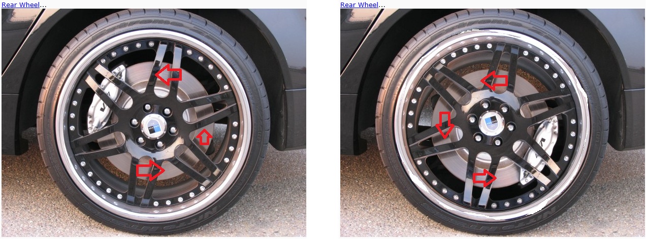

mike@thepowdercoater.com originally posted this in a self standing thread. I thought it was worth reporting it here. Thanks for a great tip Mike.
Originally Posted by mike@thepowdercoater.com View Post
I know its a popular upgrade, but be advised that when swapping the rears out for cadillac rears, the balance tubes should be moved to the opposite side of the cadillac caliper before installation.
On the camaro caliper, the crossover tube is on the side with the smaller piston. Because the caliper sits on the leading edge of the rotor on the cadillac, rather than the trailing edge like the camaro, the crossover tube is on the side with the larger piston.
The reason for the difference is pad wear and taper. The leading edge wears faster and generates more heat, so to compensate for it, perfomance caliper manufacturers put smaller pistons on the leading edge.
Fronts are oriented the same on both cars, so if doing a front only upgrade there is no issue.
Just some friendly advice from your local powdercoater.
That is a great tip. We did flip them on our install, but I do not think we made it as clear as you did.
I've got the gen1 CTS-V calipers on the front of my G8. Now that we have a solution for keeping the ebrake, I'm looking to complete the installation with the gen1 CTS-V calipers on the rear.
Both gen1 and gen2 CTS-V models had the rear calipers mounted on the forward side of the rotor. Both also had the crossover tube on the lower side of the caliper, which based on what Mike said, would be on the LARGER piston.
I'm trying to grasp the design rational of the larger vs smaller pistons, and position relative to the rotor. Is the mounting of the CTS caliper on the "leading edge" of the rotor considered "leading edge" because it is "forward" of the axle, vs the Camaro on the "trailing edge" because it is "aft" of the axle?
I was thinking the "leading edge" of the rotor would be the first portion of the rotor to enter the caliper, hitting the pad first.
Could you please elaborate on this for me? THANKS!
08G8V8 is offline   Reply With Quote
You are correct.
The leading edge is in reference to the rotation of the rotor to the caliper when driving forward. We'll call the smaller Piston #1. When the Caliper is mounted on the front side of the rotor Piston #1 is on top and the cross-over tube on the bottom. To keep the leading edge orientation the same when mounted on the backside of the leading edge Piston #1 is on the bottom. That is why the cross-over tube is moved.
Last edited by JusticePete; 09-08-2011 at 11:51 AM. Reason: Corrected large to small

Here is a photo of a drivers side rear CTS-V on the left. As you state, the smaller Piston #1 is on the top of the caliper and the cross-over tube is on the bottom of the caliper. As the rotor goes around forward, it hits Piston #1 first.
You take that same drivers side rear CTS-V caliper and rotate is 180 degrees to mount it on the rear of the axle, the picture on the right, Piston #1 now moves to the bottom of the caliper and the cross-over tube to the top. Rotor rotation remains the same, so as the rotor rotates forward, it still hits Piston #1 first.
This looks like it keeps the leading edge orientation as you stated above. What am I missing here?
Here is a photo of a drivers side rear CTS-V on the left. As you state, the larger Piston #1 is on the top of the caliper and the cross-over tube is on the bottom of the caliper. As the rotor goes around forward, it hits Piston #1 first.
The bleeder port is on the bottom when the caliper is aft of the axle! You can't bleed it that way....
