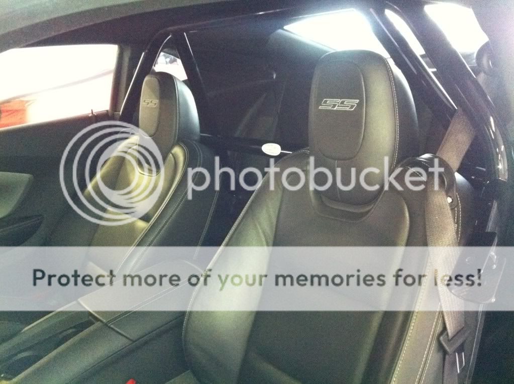

Posts: 262
we recently installed an rpm drag race rollbar for the 5th gen, im getting some pics now

Old 09-09-2011, 09:52 AM   #4
Darkstar November
Drives: 2011 Mustang GT
Location: south florida
Posts: 262
Darkstar November is offline   Reply With Quote

Posts: 262
its an RPM bolt in kit they supply. you just have to do the mounting and trimming
