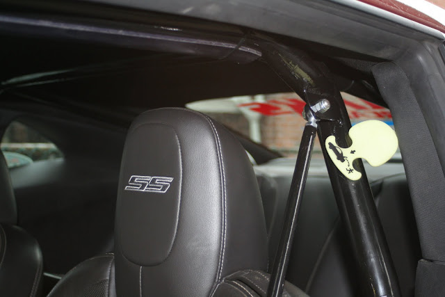

We just finished installing the full cage at Farks Supercars this past weekend.
We put a lot of time into planning this cage so that it affects visibility and comfort as little as possible. Due to the space that was required for the now removed side curtain airbags the headliner bulged out right by the drivers head. To keep the bar as far to the outside of the car as possible we cut a notch in the headliner and actually fit half of the bar into the liner. The roof cross bar was also tucked up as close to the headliner and does not affect visibility much at all.
Nice shot of the window net
All TIG welded chrolomy tubing.
http://www.farkssupercars.com
We also had the car on scales at Farks and the car without a driver weighed 3600 lbs.

looks pretty sweet. Question, why do you have the trunk release thingy next to your roll cage?
