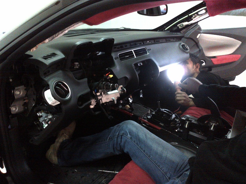

Finally we started at 10 am with the HUD Install and Finished at around 6 30 pm 8 hours with a Lunch break the Removing of the dash and putting it back didn't take as much time as the Cutting of the dash, still my dash suffered a scratch and where the hud switch is located also suffered 2 bruises but it well worth it ill cover them later with some leather inserts.
I send my sincere gratitude to Ofer who helped me over the phone, and for the harness. Ofer ur kindness is very well appriciated wish u all the best.
Patric thank you for the parts.
Now I'm proud to have the 1st 2010 Camaro with and HUD in the Middle East

Patrick these are the pics that I took, Not alot, sorry for the poor quality they were taken with my blackberry. I was concentrating alot on the job and i am not in any of the pics. We were 4 guys working on the car.
The car originally came with Black Leather, and I didnt like the Inferno Orange I had someone remove the Leather upholstery and Diamond double stich Red Suede, the Headliner is all Suede. Funny enough when we Removed the OEM Leather, It wasnt Real Leather, It was Synthetic I thought that was a rip-off from GM.
