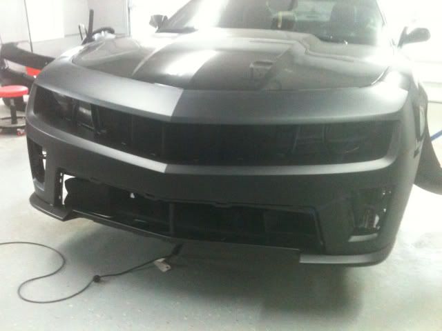

Haha the kind that adm performance would have to come up with. The grille fills in the whole space where front of scoop is and it does not allign if u were to trim even
