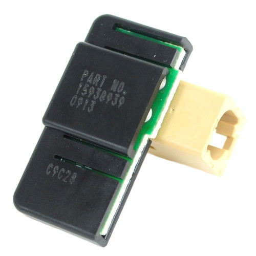

Old 05-18-2012, 09:57 PM   #12
toml_pa
ʇuɐıʌǝp lɐıɔos
Drives: 2011 2SS/RS LS3/M6
Location: Pennsylvania
Posts: 231
Originally Posted by MikeOD View Post
Does your hands free through bluetooth to the cell phone still work? I assume that the BT antenna is internal to the box anyways as it's such a short range...and the cell phone obviously provides the connection to the world at that point.
Mine does not work because I unplugged both the antennas not knowing at the time one was Bluetooth. The coax cable is onstar and picture below is the Bluetooth antenna that plugs into the box. XM radio and the Universal Remote System work. The compass does not work and just displays 2 minus signs. Here is a DIY post on another forum that has some interesting info. I seems one guy with a 2012 unplugged his antenna and Onstar still worked. I would think if I plugged the Bluetooth antenna back in it would work since the box is still powered. It is fairly easy to access the box so just try it and see.
toml_pa is offline   Reply With Quote
Old 05-18-2012, 10:12 PM   #13
Lee123
Lee123's Avatar
Drives: 2012 2SS M6
Join Date: Dec 2011
Location: Phoenix, AZ
Posts: 768
Originally Posted by toml_pa View Post
Mine does not work because I unplugged both the antennas not knowing at the time one was Bluetooth. The coax cable is onstar and picture below is the Bluetooth antenna that plugs into the box. XM radio and the Universal Remote System work. The compass does not work and just displays 2 minus signs. Here is a DIY post on another forum that has some interesting info. I seems one guy with a 2012 unplugged his antenna and Onstar still worked. I would think if I plugged the Bluetooth antenna back in it would work since the box is still powered. It is fairly easy to access the box so just try it and see. Maybe it works because there are cell towers near my house. Beats me.
Attachment 373184
I'm the guy who unhooked the antenna and it still worked. When I first unhooked it I tried calling Onstar and it didn't connect, the light in the mirror was red instead of green, and the compass said CAL. I assumed it was disabled. Then a month later I got the monthly report email and it showed the correct mileage. I went out to the car, pushed the Onstar button and it rang 4 or 5 times then connected. I was shocked, so I tried it again and it worked again. I pulled the glove box out and the antenna connector was no where near the plug. I actually wondered if Onstar had found a way to connect without the antenna, perhaps to prevent a thief from disabling it by breaking the shark fin.

Old 05-19-2012, 11:09 AM   #14
toml_pa
ʇuɐıʌǝp lɐıɔos
Posts: 231
Maybe there is an internal backup antenna in case the regular one gets damaged in a crash. Did you ever get it completely off? Makes me wonder if mine is still functional. I looked this morning and I also have the fuse pulled. I really don't have any way of testing it. I also told Onstar to disable it the first time they called me. Might try disconnecting the backup battery and see if I get any DTCs.
