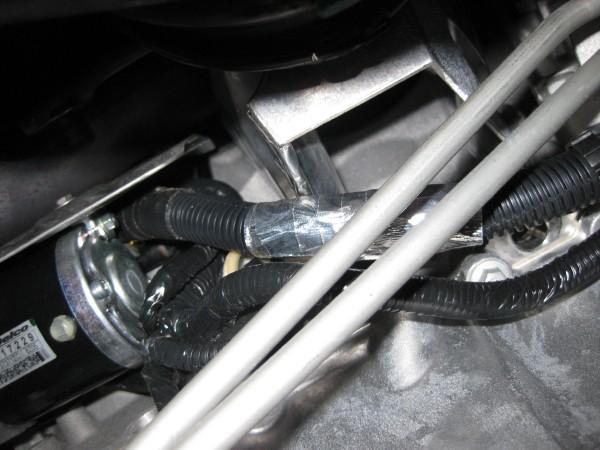

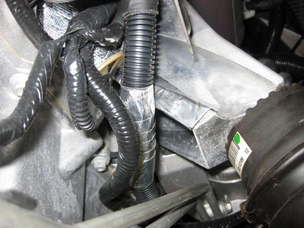

Some pictures of my car with the finished campaign...
You can see where the tape is applied on both the positive cable and the engine mount. After loosening up the positive cable an installing the two copper washers and one brass nut there was plenty of slack. There was no need to file on the engine mount; the mount had no sharp edges on it.

So there just putting metal shielding for the fix.
slholle is offline   Reply With Quote
Old 05-19-2009, 07:54 AM   #159
camaro1
camaro1's Avatar
Drives: 550+RWHP 2010 camaro
Join Date: Sep 2007
Location: wisconsin
Posts: 1,588
for the dealer fix, yes just tape on the harness, and file down any sharp edge's on the mount
i think the fix going on at qc is a little more involved, otherwise why wouldnt the just send the cars to the dealers and place a hold on them till they were fixed,, would be a heck-of a lot faster to have all the dealers fix them rather than a few guys trying to fix thousands of cars
