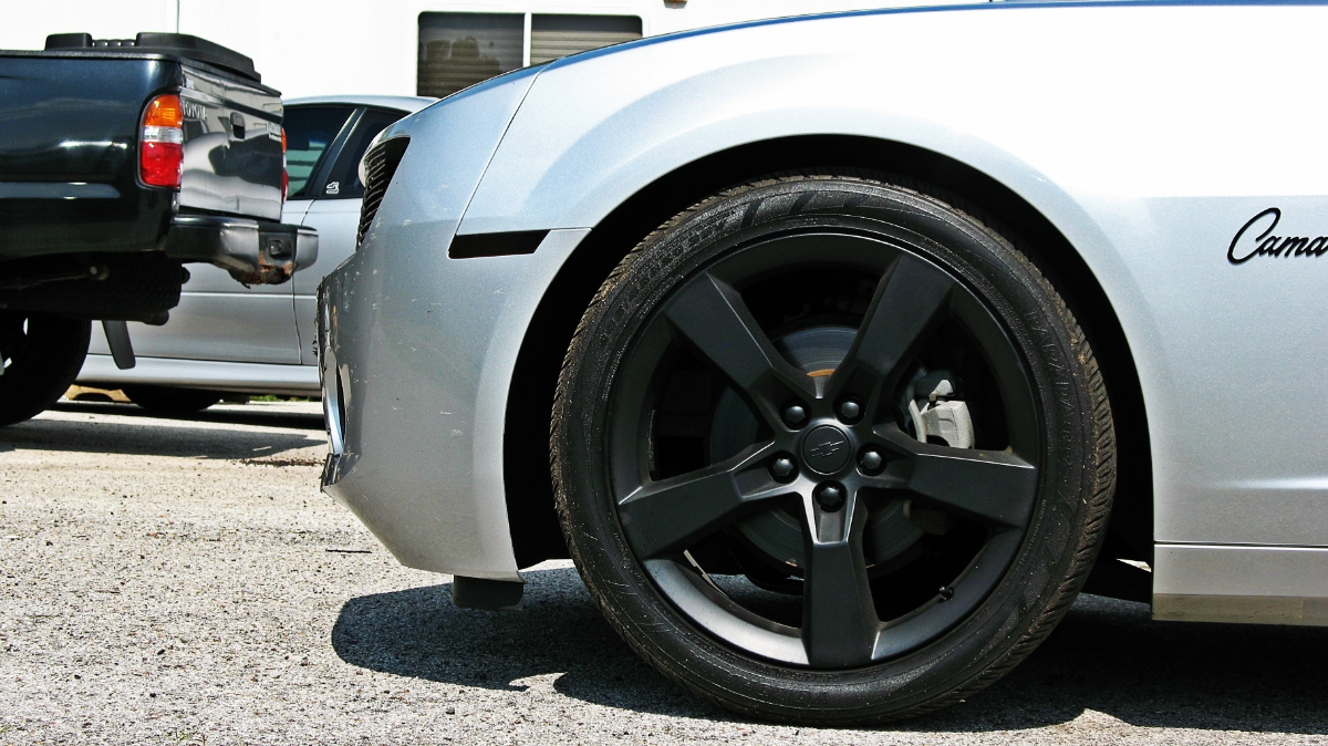

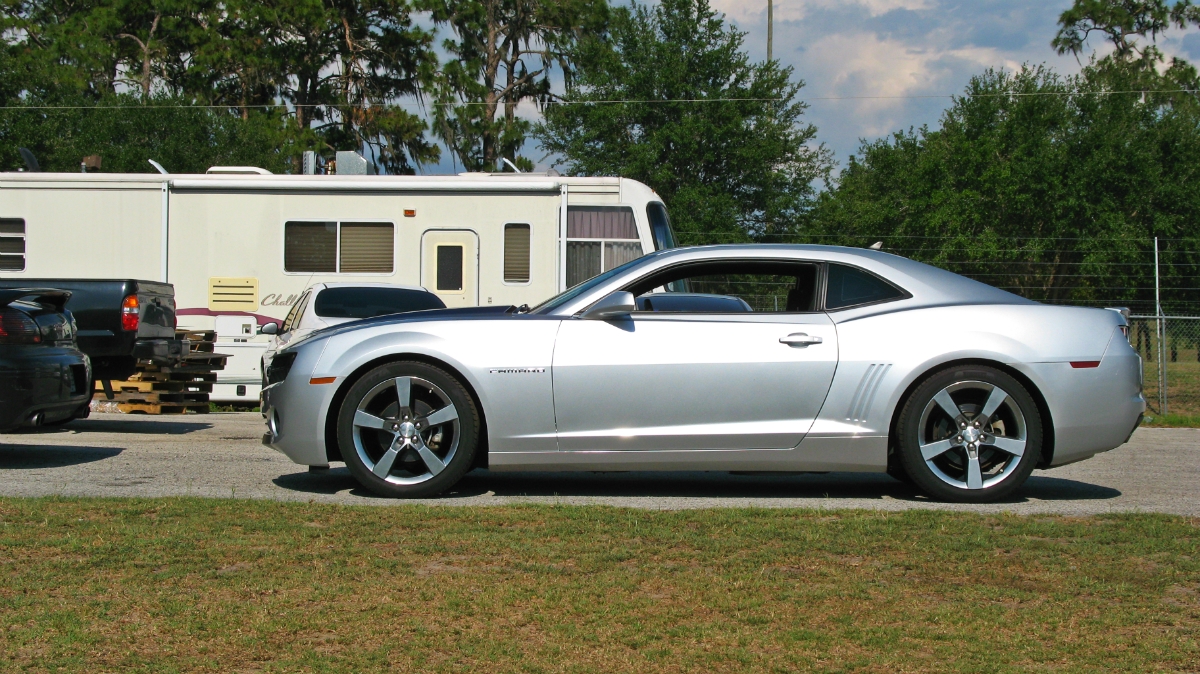

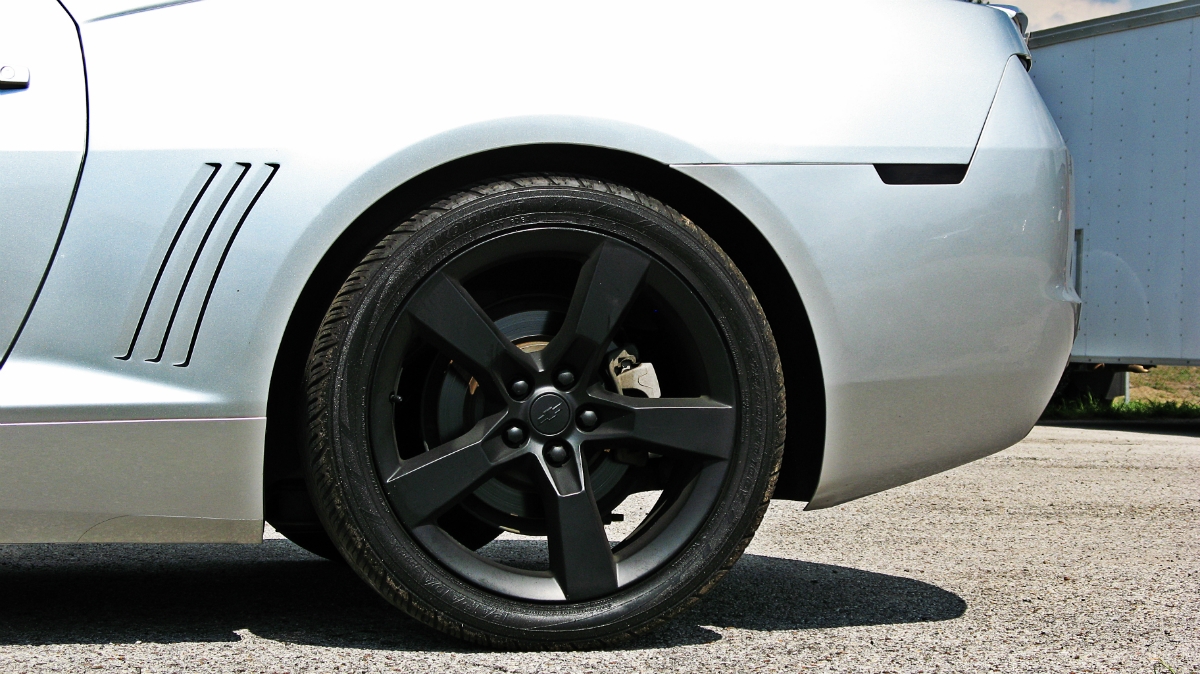

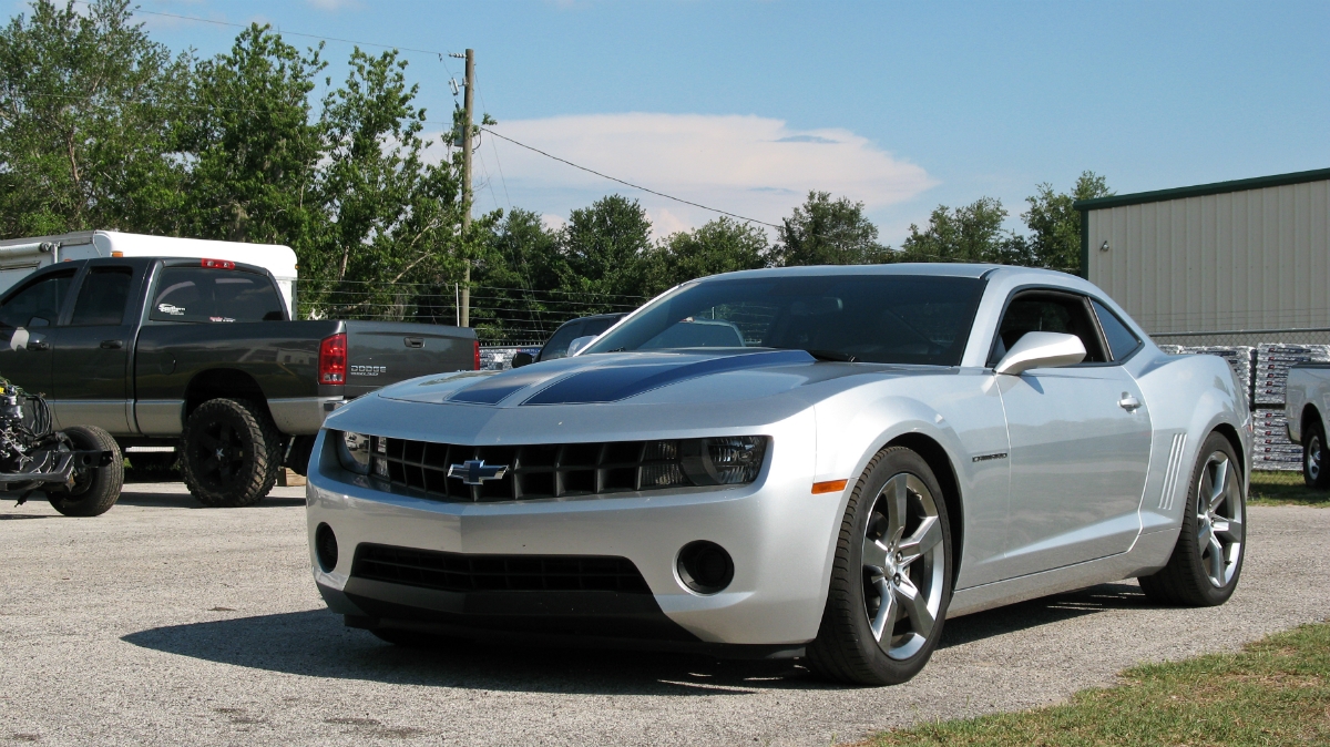

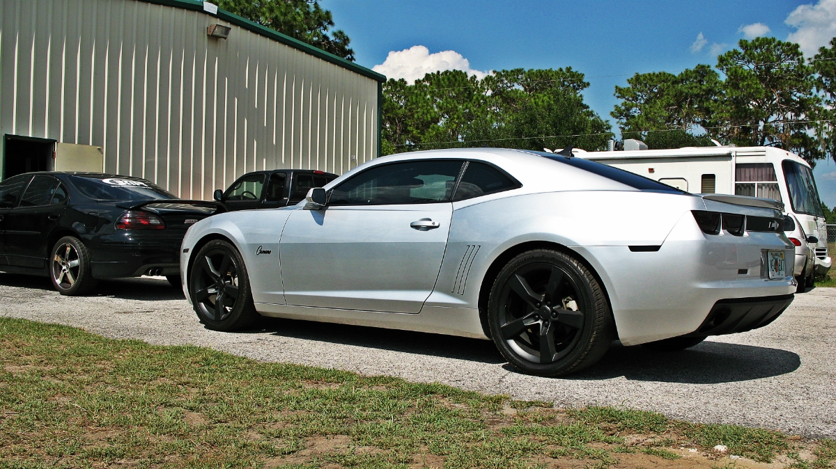

We just finished up designing and releasing our V6 specific BMR lowering springs which lower the car 1.25". Here are a couple pictures of some of our test cars that we used which show the stance given by our springs. Let me know idf you have any questions or if we can help you out.
