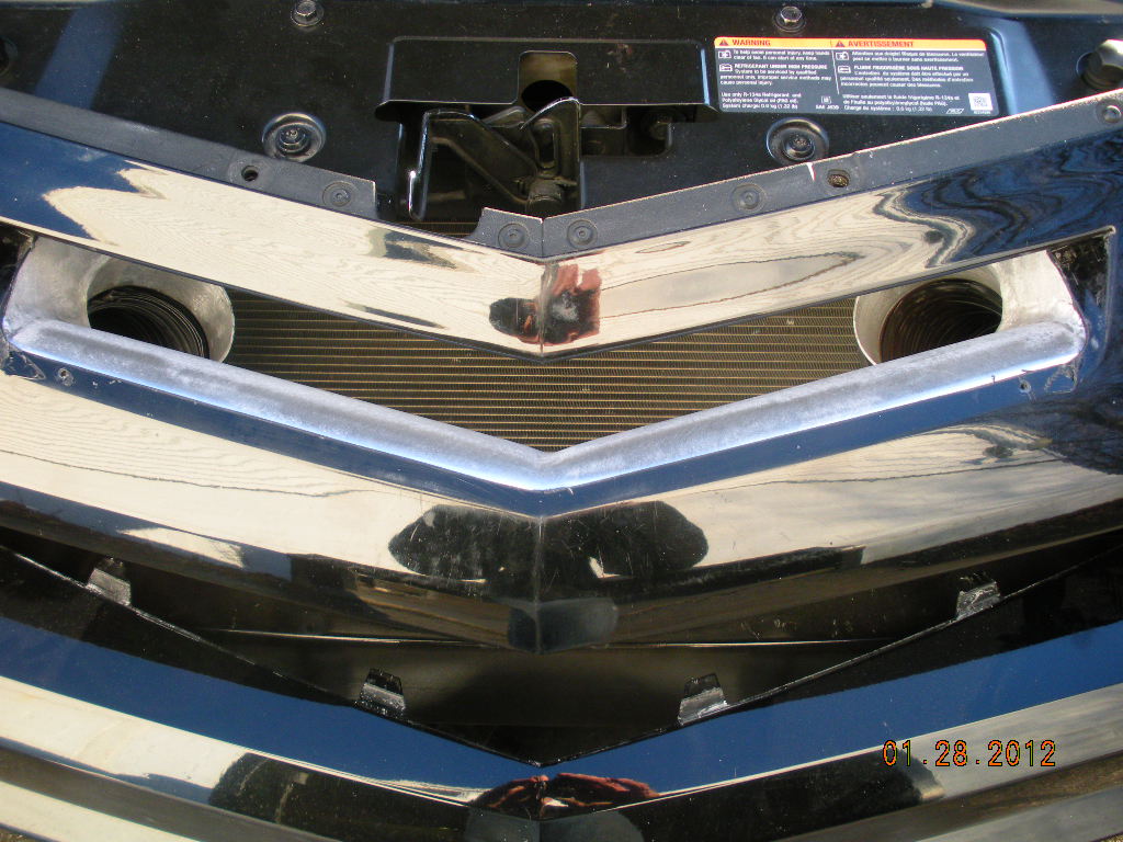

Frankly why mess with Chevy"s work unless it yields a way of feeding a CAI box directly, like the old shaker hoods, or directly to the TB thru a straight vararam style intake? That would get my money in a hurry.[/QUOTE]
Utilizing the mailslot to feed a CAI is not that difficult, here are a couple of quick pics of how I did it
