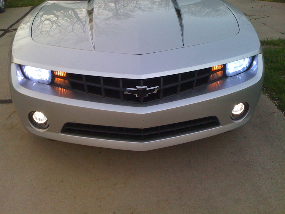

Old 08-20-2012, 12:04 AM   #7
Chevrole+
Chevrole+'s Avatar
Drives: 2010 Camaro 2LT
Location: Northern KY
Posts: 454
oh and i have these on mine. hope this helps!

Old 08-20-2012, 04:44 PM   #8
hsoj10
hsoj10's Avatar
Drives: 2010 Camaro 2SS/RS SIM
Location: Oklahoma
Posts: 218
Did you install your hood spears yourself? If so, was it difficult?

Old 08-20-2012, 08:53 PM   #9
Chevrole+
Chevrole+'s Avatar
Posts: 454
I did not! but vinyl work was all I did in high school. we had a class for it and i was the top in the class. as long as it is a certain vinyl which i would imagine this vinyl is a 10-12 year exterior vinyl, you can spray water underneath it so you can move it around a bit to line it up correctly.
Use a soft squeegy to get all of the water and bubbles out and run the car (for the heat) for a while to make sure that it is completely dry. Will probably take a few days, just make sure noone touches it for a few days and you should be fine.
I did alot of my 87 Monte Carlo SS in vinyl and it turned out great. The bigger pieces are harder to do, and i did an 8FT in length 8IN in width section at a time.
