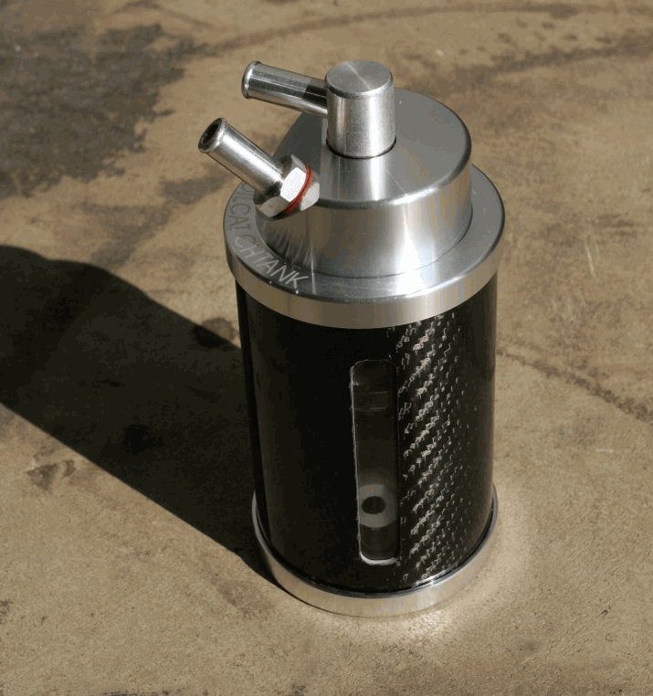

oil catch tank
i bought this cool carbon fiber oil catch tank with a window in it..

oil catch tank
sammyv i got this from fastwrx.com in va. 75.00 + 8.00 shipping, i like the sight glass in it for easy view of oil level and the carbon fiber also. best deal i have found to date. this goes great with my carbon fiber intake tube as well. thanks mark

Posts: 6,063
It is an empty liquid overflow tank....does not separate oil from the crankcase vapors. Would work great as a radiator overflow, etc. but its just an empty can w/fittings on it....not an oil sperator. Looks nice though!

works well
yeah this oil catch can has a separator plate with a down tube thru the center and a stainless screen below that, the subaru race guys use this and it works great, two sight glasses to watch it work...
LOL! No intention of insulting you....just sharing info as you paid a premium to have a car as awesome as a ZL1. Tell you what....test it for yourself. spend $8-10 for a clear glass inline fuel filter and install it between your intake manifold and the can outlet and watch how much oil this can lets past. It looks great, and even a beer can with 2 fittings in (yes, we tested that as a joke and were surprised how much oil it caught) will catch oil...any container that allows cooling will condense some of the oil out of the crankcase vapors.....but the idea, especially with a DI motor is to trap ALL the oil, not just a small portion of it. All I'm doing is sharing with you the functions and how to test for yourself. Dont take my word for any of it (yes, we have that same can disected in house on display with the other dozen or so we test).....do it and see for yourself.
It is far better than no can at all so your helpping a portion of the issue, but you want no oil in your intake air charge. Especially with a ZL1 as you want no oil residue build up on your blower rotors as over time the build up throws the balance off....and then the intercooler is mounted below the blower and this si what happens to it in short order as the oil bakes on the fins, etc:

OK, I ordered one of the wrx cans...and it arrived. Didnt spend the extra for the hydro coat finish as after we test these we cut them apart to show the inner workings.
Here is the diagram:
It is just a made it china can that the majority of the vapors come in the ceter tube and right out the outlet as you can see. The screen in the center is below the inlet tube so it does nothing. This is no different in function than the orange juice bottle shown but does look great.
Below is a picture to show how the oil is separating in a properly functiong can.
You guys have spent the $ for a king of the camaros ZL1, but have put a can on the allows as much or more oil through and still into the intake tan it traps, so you will still have the same issues....just a little later as you are trapping some of the oil.
Remeber, its not the oil you capture...its what still passes through and with these cheap cans that are really nothing more than an empty can w/2 fittings in let more through than they catch:
Look close at this picture, (these are the parts before final assy and finishing so you can see just what is needed to separate and trap the oil from the crankcase vapors) The vapors enter the center of the can, then they travel down the inlet tube which passes through the separate outlet chamber so no vapors are mixed with the exiting vapors that have already had the oil separated and trapped. Then as the tube passes into the seaparate coalescing chamber, it is dispersed into a coalesing media that traps nearly all the oil which then drips out drains in the bottom of the coalesing chamber into the condesing and colletion chamber (all of these now are totally separate form all other as this is a complex process and you cannot allow the incoming and outgoing vapors to ever comingle or the process is compromised).
Then the vapors are cooled in the condesing chamber and any oil still in suspension is then condensed to droplets that fall out of supension as the vapors are drawn up the outer (cooling surface) wall of the can evenly and into the separate outlet chamber where there are integrated flow controlling check valves that prevent any reversion at WOT from pushing vapors backwards through the can.
This is the most effective and robust design in the industry period aside from going to the $8-$12k centrifuge style Alfa Laval uniits used on industrial diesel applications.
The industry is full of empty, or near empty cans called "oil catchcan" and sold as separating cans.......and this is so confusing to those that are not knowledgable on the function and purpose for them.
There are several other cans that work great trapping most of the oil but none with the engineering you see in the pictures above.
The ones we have tested in depth and disected are (in order of effectiveness, and they all work very well):
RX Products
Saikou Micchi
Elite Engineering
AMW
Maike Norris/CCA.
These, and only these worked well enough to be reccomended by us and we have tested most every one on the market (as any that have visited our facility in person and seen the collection on display) and there are some that cost over $200 and look awesome ....and some with some of the biggest names in the performance industry let nearly as much through as they trap....it is all in understanding the issue, the function, and the process for actually effectively separating the oil vapor/mist from the crankcase vapors and most you see for sale are companies jumping on the bandwagon to just sell a product.
Hope this helps those wanting to fully understand this.
