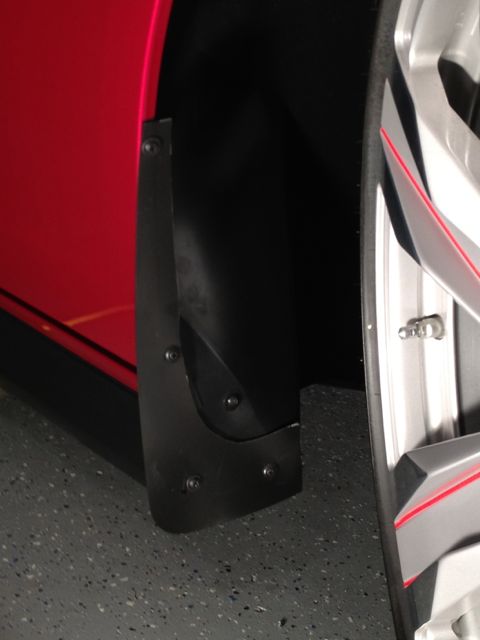

I made my own. Used a piece of card board to trace the back "canard" as the template, and modified the shape slightly.
Purchased some flat "truck" sized splash guards, used tin snips to cut and trimmed to fit. Gave the cut edges of the matched pair a quick sand with my belt sander.
Used little slip clips to mount to fender. Placed a strip of electrical tape between the paint and splash guard.

Exclamation
OK got some more pics up:
Mounting - Yes I need to paint the clips:
Finished look:

Here's how mine came out
I took THR's idea and here's how mine came out. I didn't use electrical tape between the flap and paint since the flap only sits against the fender wall lip and the flap does not "flap" in the wind.

Here is how mine came out when I visited all the DIY threads. These should of came from the factory just like this.
