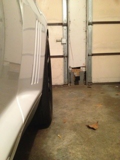

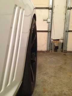

Assuming with the right offset, you would have no issues with the tire sticking out past the fender and spraying the sides of the car with debris either?

With the correct offset the wheels do not stick out, mine tuck quite nicely.
