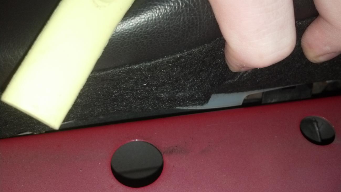

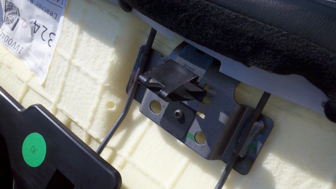

Help! I have a new 2013 ZL1 vert and can't figure out how the remove the top rear seat portion? I have started to put down some dynamat and it looks pretty good but I need to do the rest of the car. Please tell me how to get that top section out, thanks. Please PM me.
2 bolts on each side and 1 Nut in the middle, and it comes right out. If the Vert is the same..
OVERPAR73 It is not the same... Two clips at the top along the middle trim piece. Drop your top and get you a flat head screw driver. Ya want to press down and towards the seatback. But like I posted somewhere else that you asked about this. There is really nothing to dynamat.

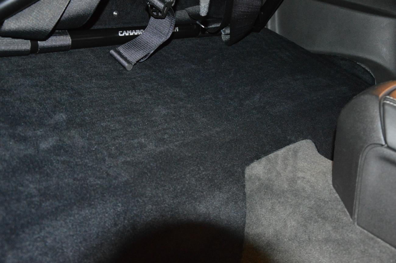

Here is my selfmade Kit!

Nice!! Helmet is bad ass!!

Has anyone done a rear seat delete that has a lip on the end by the back of the front seats so as to keep it functional for storage?? If not i might have to do this.

Do you think so?

It's been a while since I've been on this thead. Sick rear seat delete. I still haven't done mine. I laid down some sound deadner in the rear seat area and I'm on the verge of finishing the seat delete. What material did you use to do yours?

^What materials did you use and where did you get them? Thanks!
