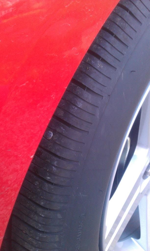

Hey guys, been a while since I had a tire patched (like, since I had my last truck). I noticed my DIC said I had low air after work. Took a look, sure enough, caught a nail
Is that far enough way from the sidewall for a patch? It's about dead center in the outer row of tread.
I'm taking it to the dealer tomorrow after I get off to have it taken care of.

its a syn
B.O.D. 02/16/10
its a syn's Avatar
Drives: 2010 SGM Sp. Edition 2017 RS Conver
Location: Albia,Iowa
Posts: 3,959
They may plug it

boozeitup
boozeitup's Avatar
Drives: 2011 2ss Vert
Location: Stewartstown, Pennsylvania
Posts: 23
I will say that they will not. I got one in that exact place and pep boys would not plug it. I am not a mechanic but if I could have I would have plugged it and then just monitored it.

spyder
Drives: 2010 V6 | M6
Location: new york
Posts: 298
I'm pretty sure that can be patched/plugged.

ripcurl329
Drives: 2012 SS/RS 45th & 1970 SS/RS 350
Location: Fredericksburg, VA
Posts: 140
I would do a patch & plugged it might be a few $$ more but well worth it IMO.

SimpleGreen
Drives: 2015 2SS/RS
Location: Southeast Louisiana
Posts: 2,112
Interesting, I have never seen a tire shop just do a plug alone? All mine have always been buffed and patched on the inside.
Being a daily driver, I'm going to go the most reliable route.

Jason@JacFab
Drives: 2016 1LT RS Camaro; 72 Chevelle
Location: Central Point, OR
Posts: 5,685
Send a message via AIM to Jason@JacFab Send a message via MSN to Jason@JacFab
Hard to say on that one... Keep trying places until you get someone to fix it? About a month ago I ran over what Schwabb said was probably a razor blade. The day I needed it fixed Schwabb was closed so I took it to Walmart, they said they would not/could not plug it as it was a "cut" and it would continue to split.
Schwabb uses some kind of plug/patch combo things, they fixed it no problem. It's still holding together.

Avalnch
Avalnch's Avatar
Drives: Rally Yellow Camaro+Avalanche
Location: Vancouver
Posts: 1,110
That's not too close to the shoulder and patch-able. Go to a tire specialty shop and they should be able to do it for you.

Sir Nuke
Master of All Things
Sir Nuke's Avatar
Drives: '26 Corvette Stingray
Posts: 22,681
that should be DOABLE.....and after reading TONS of stuff on the subject.....the absolute best fix it to do BOTH, first plug it....then patch on the inside.

jeremywes
jeremywes's Avatar
Drives: 2012 Camaro SS
Location: Houston, TX
Posts: 504
Yep, plug and patch

Supercharged Red
Supercharged Red's Avatar
Drives: 2011 Camaro 2SS/RS A6 Victory Red
Location: Snohomish WA
Posts: 203
NOPE. Too close to the edge. They can't guarantee it so they won't do it. Sorry.

SimpleGreen
Drives: 2015 2SS/RS
Posts: 2,112
Well anywho, I made some more time and went to a local tire shop instead. They told me as long as they could buff it properly and the patch didn't ride onto the sidewall than they would do it. At any rate, it's fixed and they re-balanced the wheel/tire for a grand total of $22.
I have considered ordering a brand new tire though since I don't have many miles and just keeping this patched tire on a LS steel wheel as a backup? Think that's worth while?

AllBlckChvy
AllBlckChvy's Avatar
Drives: Black 2LS
Location: SW
Posts: 345
Tire shops should be able to patch it up. I had one bout same spot and patched it w/ no probs.
