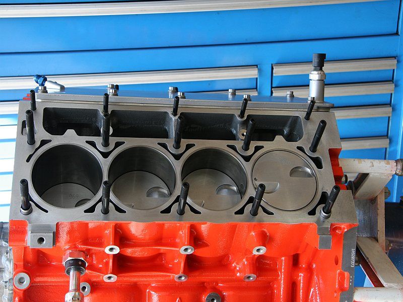

Here is a tip I learned from some top LS Engine builders. A small hole can be drilled on the bottom side of the lifter retainers. This helps to drain oil faster under high RPM.
ARP head studs are now in. Just waiting for the heads to be completed.
