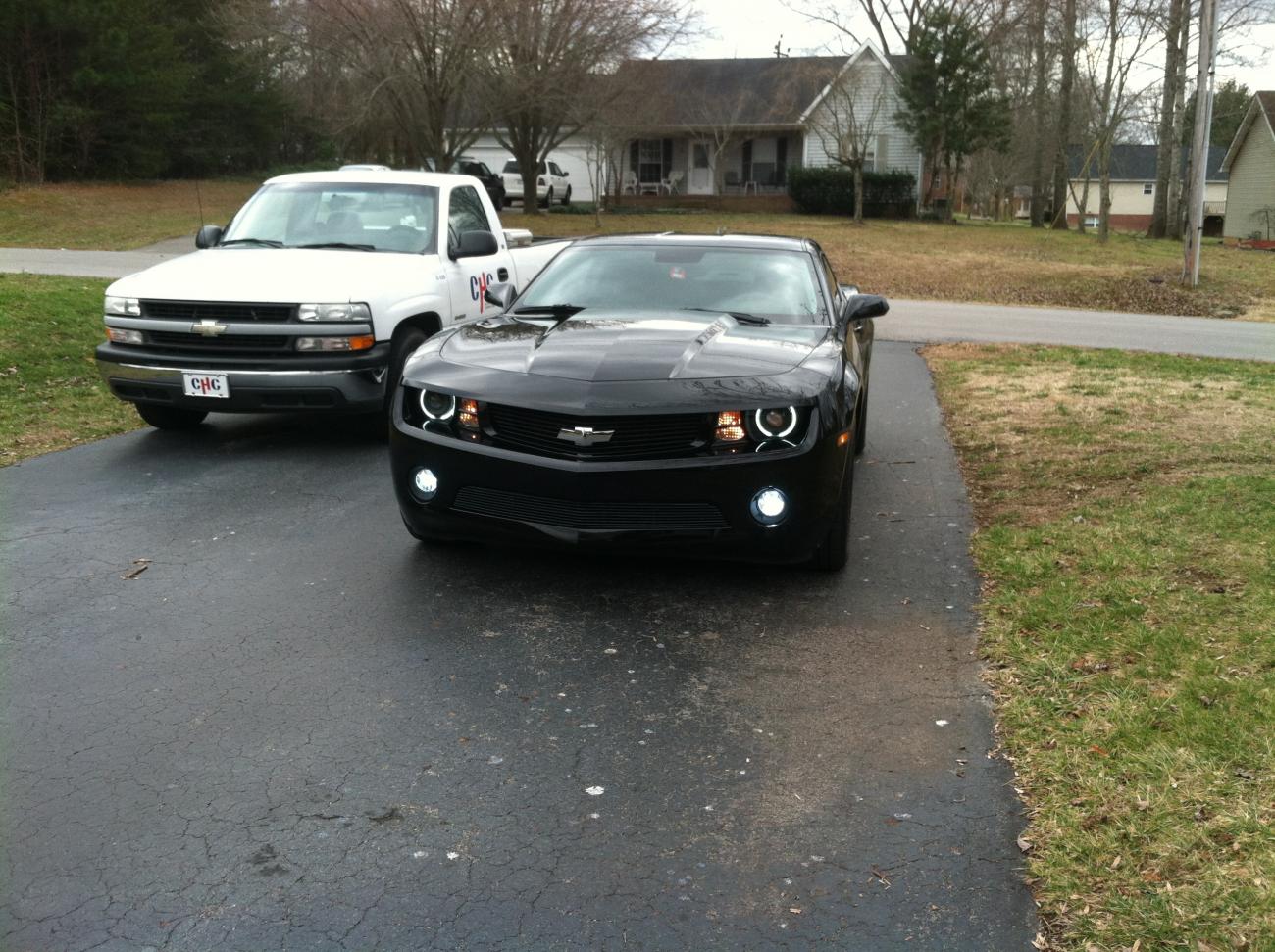

This sir, looks fantastic.
Did you wire the Halo's to the Parking Lights?
Did you somehow disable DRL - or set them to activate your Fogs + Halos?
Love this thread, thank you for taking the time to post it.
Hey thanks! I did wire the halos and fogs to the parking lights so I can just use the parking light switch to turn them on and off.

Awesome.
I think I'm going to order me some. I don't want to bake my original headlamps. This just seems easier.

It is pretty simple and straight forward. The hardest part of the entire install was taking the front bumper off, but after that it was all easy.
