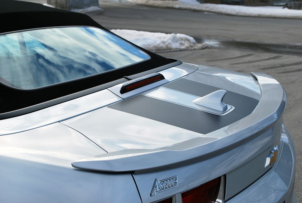

I have a 2SS/RS and a rear spoiler and the Shark antenna. No issues. Here is one of the pictures of my car from a few weeks ago.
I'm pretty sure the OP means he's trying to replace his factory spoiler.
I know I've seen some people on here do it, but you have to mess with the wiring and all that fun stuff I do believe.
