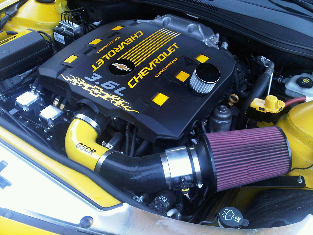

I don't know much about the Sinister hood but I do own a Nickey Chicago Stinger hood with Ram Air. I also have a G5CR CAI that has no heat shield or cover. They are on the car for 2 years now and I did'nt get any CEL or other problems.
Cold air is coming directly to the open filter and I feel that my engine is breathing a lot. So you could go this way. Sinister hood I don't know much, but Nickey has a water management system that takes all the rain or washing water in front of the hood and lets the water go doen the hood hook. I never had any water on the engine because of rain or whatso ever. Stinger hood is available at Nickey Chicago only, but the hood is fabricated by ACS Composite and it's top quality.
Here's a few pics.
