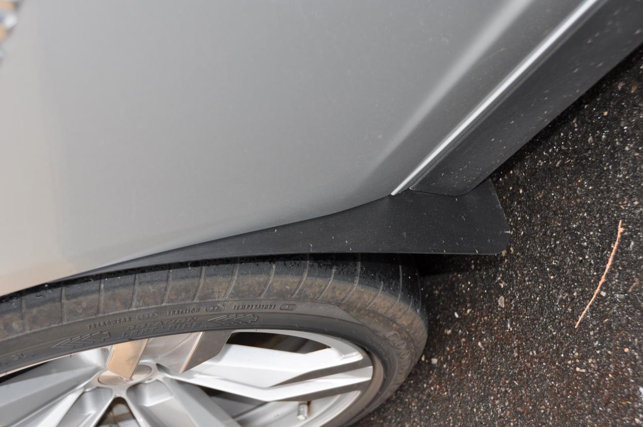

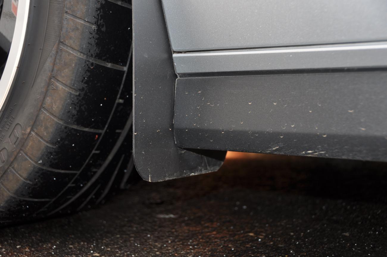

Here are my front splash guards on my ZL1. They were made from 12 x 18 flaps purchased at AZ. 3M tape and the two lower screws were used for attachment.

Good photos. Looks like a simple install with them straight and just using 3M tape.

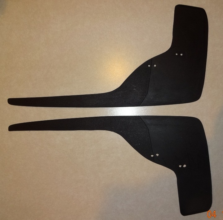

Here are photos of my set of splash / mud / rock guards. I want to do another set that has them sticking out a littlie further to block more of the wet dirty stuff.

The front needs to extend out a bit further. I first had short/narrow guards and then changed them out. The "narrow" guards in the rear work 'cause the body narrows behind the rear wheels. Behind the front wheels the body actually gets wider at the gill area.

Yeah, I got a new version that is rounded, but sticks out further. Just need to finish fitting them up.
