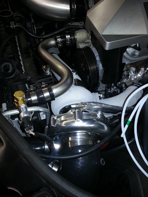

TNT523
TNT523
TNT523's Avatar
Drives: 2010 2SS/RS Blk w/cyber grey hockey
Location: West Milford, NJ
Posts: 66
Send a message via ICQ to TNT523
OK... this is what I have up to date.... first off I have to say the crew @ East Coast Superchargers does not just work with superchargers.. they install and tune FI period. If your within several hrs from Cream Ridge NJ you need to look into doug tuning your gear.... just sayin'... anyway you can clearly see the white lightning coating from swain tech.... cool stuff to keep the hot stuff inside.... the turbonetics kit comes with a huge intercooler and a very good size 76mm turbonetics turbo.. this turbo has ceramic ball bearings and is oil fed and water cooled.. the advantage of keeping the turbo as a front or top mount is the oil returns to the pan (yes you have to drill a hole in your oil pan) via gravity instead of a pump which is a good thing... That is an AIS meth tank in the trunk made specific for the 5th gen Camaro and saves valuable trunk space while keeping 4 gal of meth @ the ready....call Rodney @ AIS if you want one... It has a low fluid warning light as well as a notch behind it to mount the meth pump.... Looks tits too !!!

Originally Posted by Smirnoff View Post
Tom - appreciate the update, great move on the pipe coating.....just read about this kit, do you have any photos you can post? Also, what kind of boost are you running to achieve your peak HP/TQ#'s?
I posted some pics just now... It's 5:40 am... I will post more as soon as I can.... I had ESC swap out the 6.5lb springs included with the kit for turbonetics evolution wastgate 9lb springs which are the largest that I know of.. I'm pretty sure the dyno sheet will show a peak spike above 9lbs but I haven't seen it yet so your guess is as good as mine.. no boost controller here just running what the spings will provide.. will update once I get together with doug to review the dyno sheet... and yes I will post the dyno sheet.........
Tom
