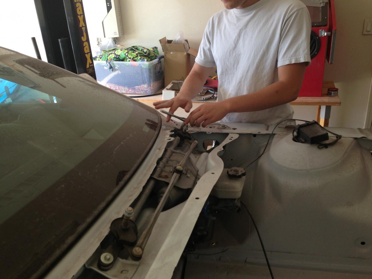

Quick Update:
Justin and I spend from working about sixteen hours combine working on G5.R today. Made a lot of progress mostly dis-assembly. We took the dash out, remove the master cylinder. We were going to remove the heater core and fan but ran into a stumbling block. The wind shield needs to come off to do it! In fact, you need to remove the wind shield, the entire dash, along with the sub structure to remove the carpet!!! GM didn't make the interior very service friendly That for dang sure.
Just a couple of pics...... The game plan has really taken on a more aggressive directions toward building a tracking car vs what my original plans were of an elegant touring car.
Pretty much everything not necessary for the most part is being removed. The Z/28 is going to be a luxury compared this G5.R! Not only is the AC and radio not going back in but the heater core, fan and all the relate stuff under the dash.
The wiper are also gone
We also removed the over hang. Still have some more grinding to do before it's finished but I have to wait till the wind shield is remove. I can't get the rest of the master cylinder plate remove till then and the studs sticking through the fire wall are in the way. The plan is to make a aluminum fire wall to cover everything.
Stay tuned as progress picks up again in the engine bay.

If I read right, he has the dash out. He thinks he needs to pull the windshield to remove some of the heater components. Neither makes sense to me, but I've only removed my dash for the HUD DIY (PITA), I haven't ventured into the heater removing.

You gotta pull the dash to get the heater core out, but the windshield doesn't have to come out to get the dash out. We have done it without glass removal, just have to be careful and it takes a little finagling.
