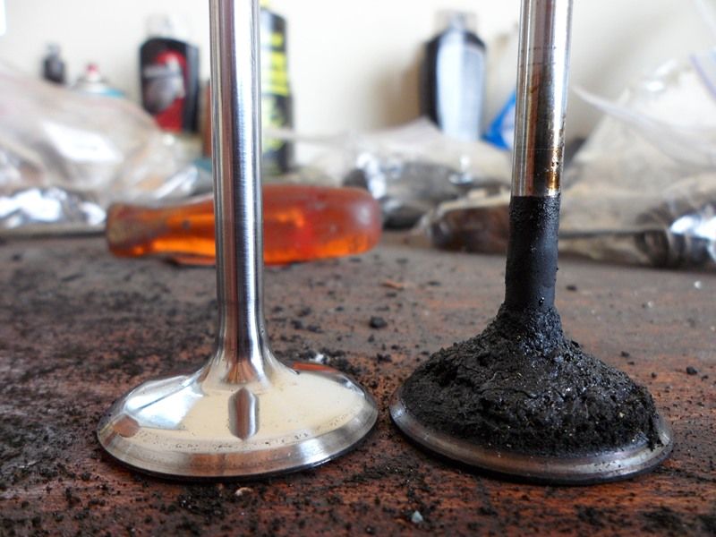

Hi i have not dynoed it yet as im assembling the car first haha but ill post figures once i have some, i do believe it might differ from camaros since i should have a bit more drivetrain loss through the 4WD but even so the camaros have loss through the Autobox again so maybe in the end it should all balance our.
SC2150, thanks for the heads up on the intake ports, i will speak to you about that soon.
Yes the piston crowns had a very rough finish and sharp corners that i just rounded a little bit and smoothed out the roughness.
As for the intake valve coking, mothertrucker i was shocked!
Out of your experience, what does this coking do to performance? am i right in saying it disturbs the velocity down the valves?
here are some before and after pics from my valves. Brace yourself.

Holy Cow!
That can't be good.

That is disgusting, good work on cleaning that mess up. Might want to invest in a catch can.

Wowzers thats quite the difference, ill go dig out my old 3.2 pistons and take some pics of how mine look in comparison. By the way my car was already on 52000 miles when i opened it up to find this.

It makes perfect sense why it would stop the build-up on the valves, etc. but why would a catch can "stop" oil consumption? It seems like the same amount of oil vapors would get pulled through the PCV system, and instead of disappearing into your intake manifold and turning into carbon deposits on your valves it stays in the can - either way you're still going to "lose" the same amount of oil?
Edit: So I read one of Tracy's post from another thread and think I have the answer to my question above - if I'm wrong please chime in. So it sounds like the oil going through the PCV system isn't the major source of oil loss, the oil loss is actually coming from improperly seating piston rings that allow oil to get into the combustion chamber on each stroke. With a catch can installed and no oil vapors coming in through the intake valves improperly seated rings may have the opportunity to reseat themselves without the contamination and thus stop or reduce the oil consumption.
