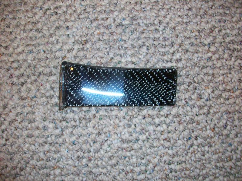

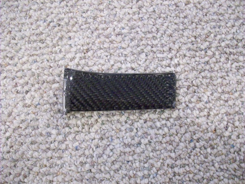

Originally Posted by Pharmaro View Post
Not sure if this has been done yet, but instead of paint, I put carbon fiber on the inside of the trim piece.
I originally intended to overlay the outside, but I have been having difficulty finishing the pieces either via polish or clearcoat. I had seen this thread and followed the instructions on removing the paint from the backside and figured maybe I could do carbon fiber on the inside and not have to worry about finishing.
Well, here are the results! It's hard to tell from the pictures, don't mind the fingerprints, but the depth is still there.
Attachment 524041
Attachment 524042
Do you have more pics?

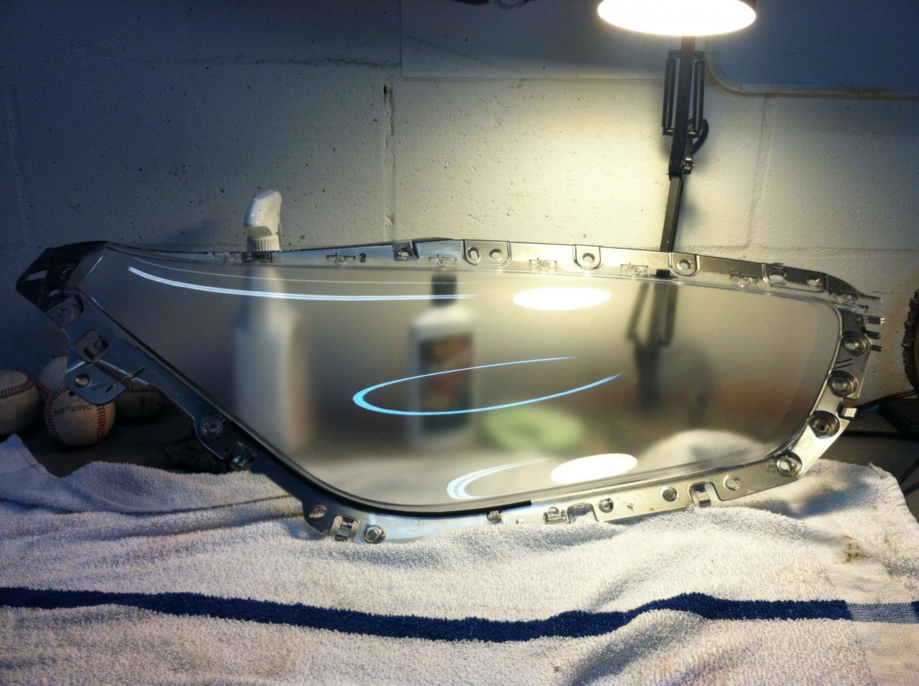

Took almost 2hrs to get perfectly clean, used krud kutter and 0000 steel wool. + a lot of patience. Plan on doing the other one soon then putting some paint on them.
Attachment 555081
That looks great!
I'm doing this soon.
GM could save us all a lot of trouble by selling these in OEM colors or clear like this. That would awesome.
