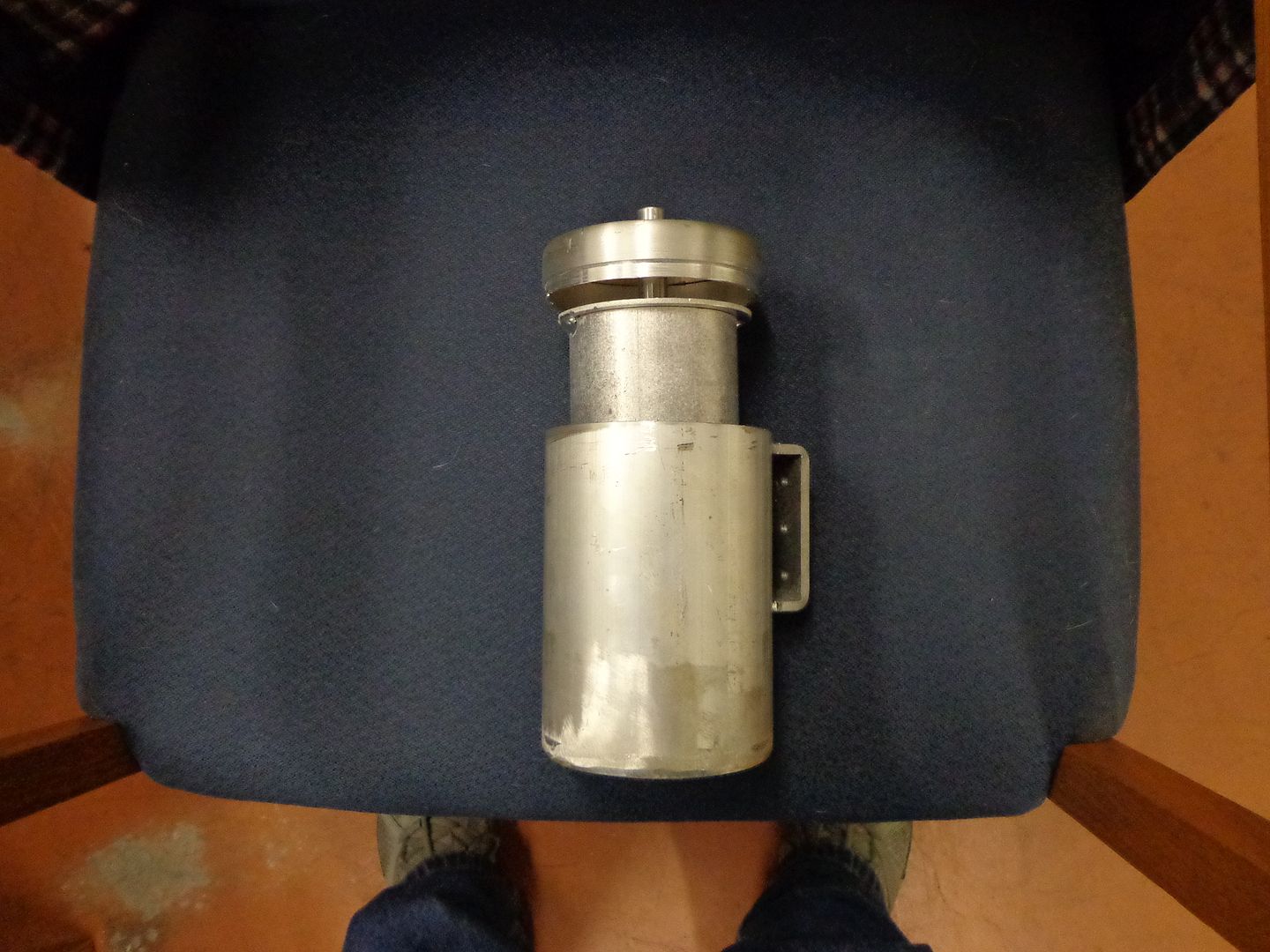

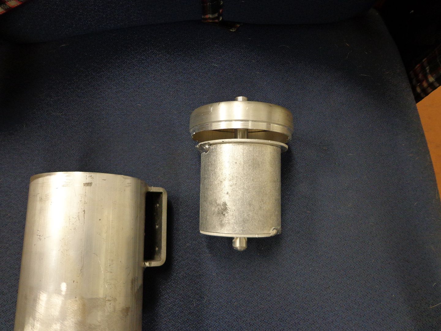

Here is the RX can dissected. 4 chambers, 3 steps, and the oil laden vapors are never mixed with the separated vapors with 14" between the inlet and outlet:
The vapors travel down a separate down tube that passes through the outlet chambers center, then is perforated allowing the vapors to evenly disperse into the coalescing chamber where 95% of the oil is separated into droplets that exit the bottom into the condensing chamber. Then the vapors are drawn past the lower disc baffle into a condensing chamber where they are forced to contact the entire outer surface to cool and condense any remaining oil to droplets that fall back into the collection chamber for disposal later. They finally pass the upper disc baffle into the separate outlet chamber where they can slow once more and exit the outlet valve(s) where any backflow, or reversion is stopped when at WOT and vacuum is not present to maintain the flow in one direction.
No other can on the market has these features, these steps, and keeping all cleaned vapors totally separate from the oil laden ones entering the can.
