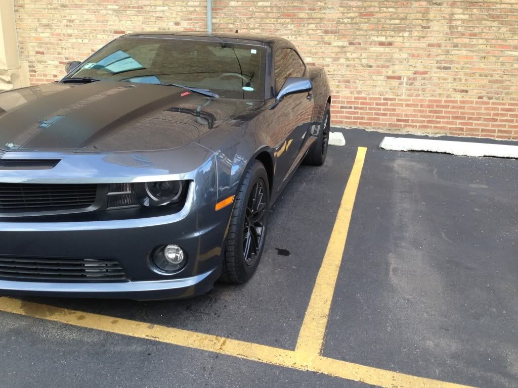

After many weeks of searching every forum and calling many rim companies I finally got it. I could never find a the perfect answer. 18 x 9.5 , 5x 120 mm with a 32 mm offset. The rim brand is Motegi Racing. I mounted a 305 45 18 Nitto NT05R. Everything clears by and inch so I can still get my tie down straps in. The setup is slighting taller but I think once I drop the tire pressure down it will be very close. Good luck everyone. This will work. Tested and Driven

I bet several of us would appreciate it if you could give us the weight of one of those.

I was not too concerned with Weight as much as getting a fit with better rubber. The shipping weight was 21 lbs each. I will be putting them to the test this weekend at Grove Creek MN on the track. I hope for better times from the car and Me LOL....

ZL1 replica 18x9.5 40MM fit in back, same tires, just tie back e-brake cable so it does not scrape the inside edge of the rim:.
You meen ZR1 replicas
