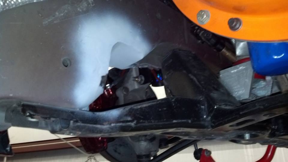

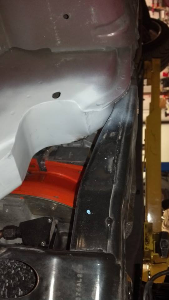

Some new car porn...
First is the frame area where it was notched to clearance the boost outlet... Three different views....

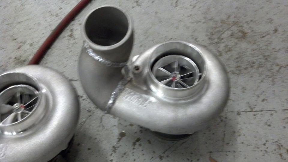

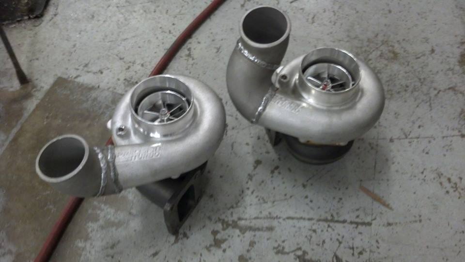

and.... here are the turbos with the weld L collars needed to exit the turbos into the boost pipes...
