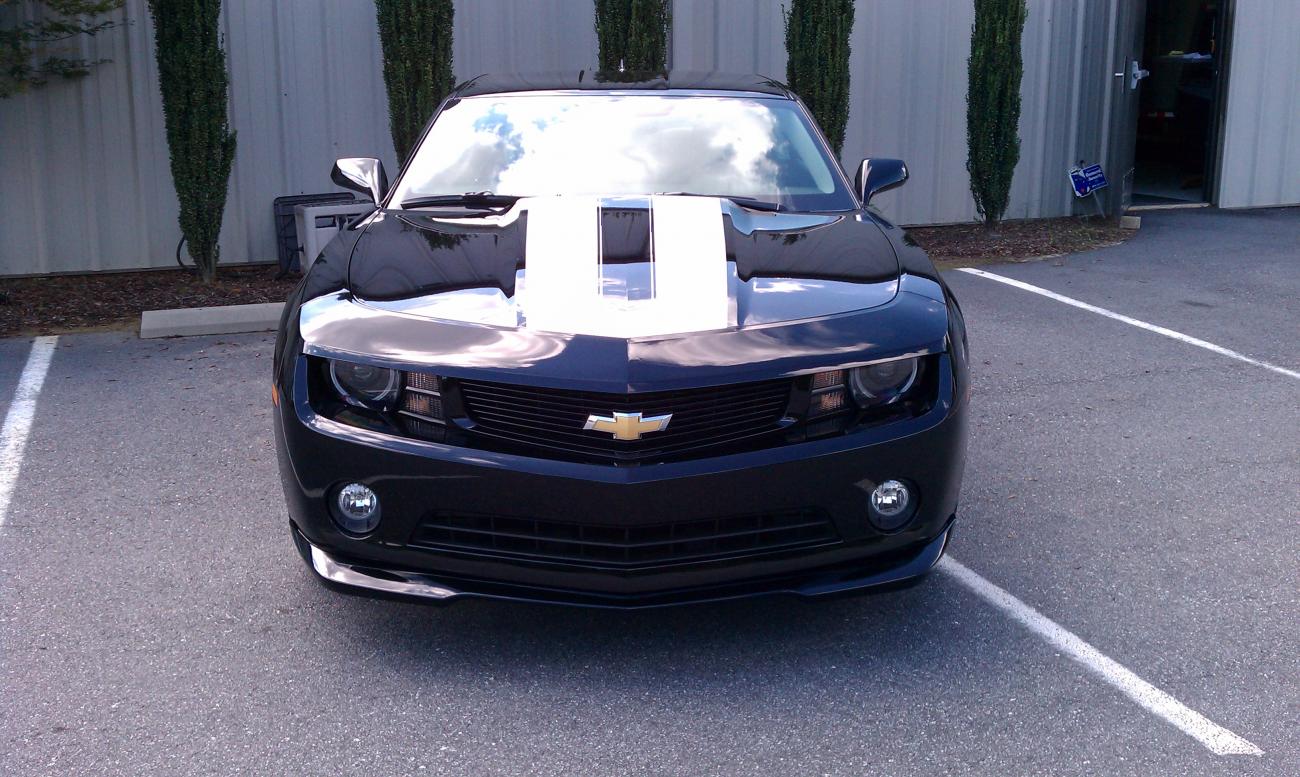

Is the GM front spoiler solid?
Is the GM front spoiler solid? I know it's a bit spongy, but would it hold a screw?
Mine has been separated from the fascia since new, and it bugs the crap out of me. I can picture it pointing strait down at highway speeds.
I have pried it apart, and cleaned it well, and put some new two sided tape in there, but it just won't hold. I believe it is in a bind from the factory.
If you look at the attached picture, you can barely see it on the drivers side at the corner of the fascia.
If anyone knows if it will hold, I would like to just put a stainless steel screw in there from the back side and be done with it. I don't like the idea of the dealership taking off the fascia to fix it their way...for obvious reasons.

I have the same black synergy, 14 of 255 and my front spolier is doing the same thing. I took it back to the dealership and was told by the body shop "It happens." My front spoiler is not too bad, I have seen photos where it looks like others have separated about a 1/4"; mine is slightly noticeable at the corners. I believe it’s just a fit and finish issue from the factory and may be effected by certain weather conditions. If you decide to use screws, I would recommend you pre-drill all the holes to prevent the material from splitting when you install the screws. Use BIG washers.

Agreed, still all your holes and use big washers. Also get stainless steel if you can, I'm not certain but I think stainless will hold up the best from the elements.

It is solid. Mine is bolted on.
