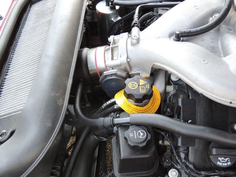

Well, I got it done thanks to my gear-head buddy with a set of NPT taps. It's gonna take a while to deal with the pics, and I want to put some miles on it, data-log, and re-check the LTFTs so stay tuned...
But at least I can say: No more oily RX breather with the puzzling check valve, and no goofy 1960s chrome breather that ships with the Vararam!!! - a closed-loop system restored.
I'm too tired to put together anything with more details (probably will in a new thread in a couple of days). Here is a quick pic of the final set-up:
It's hard to see, but yes, the tube fitting is just behind the exit port in the MAF. The funky coupling of the 3/8 hose and the OEM tube is effective, but will be addressed later. BTW - so far 30 miles on it w/no issues.

Interesting, I can't wait to see the rest of the pictures and the results of how it affected your fuel trims.

That looks great !
