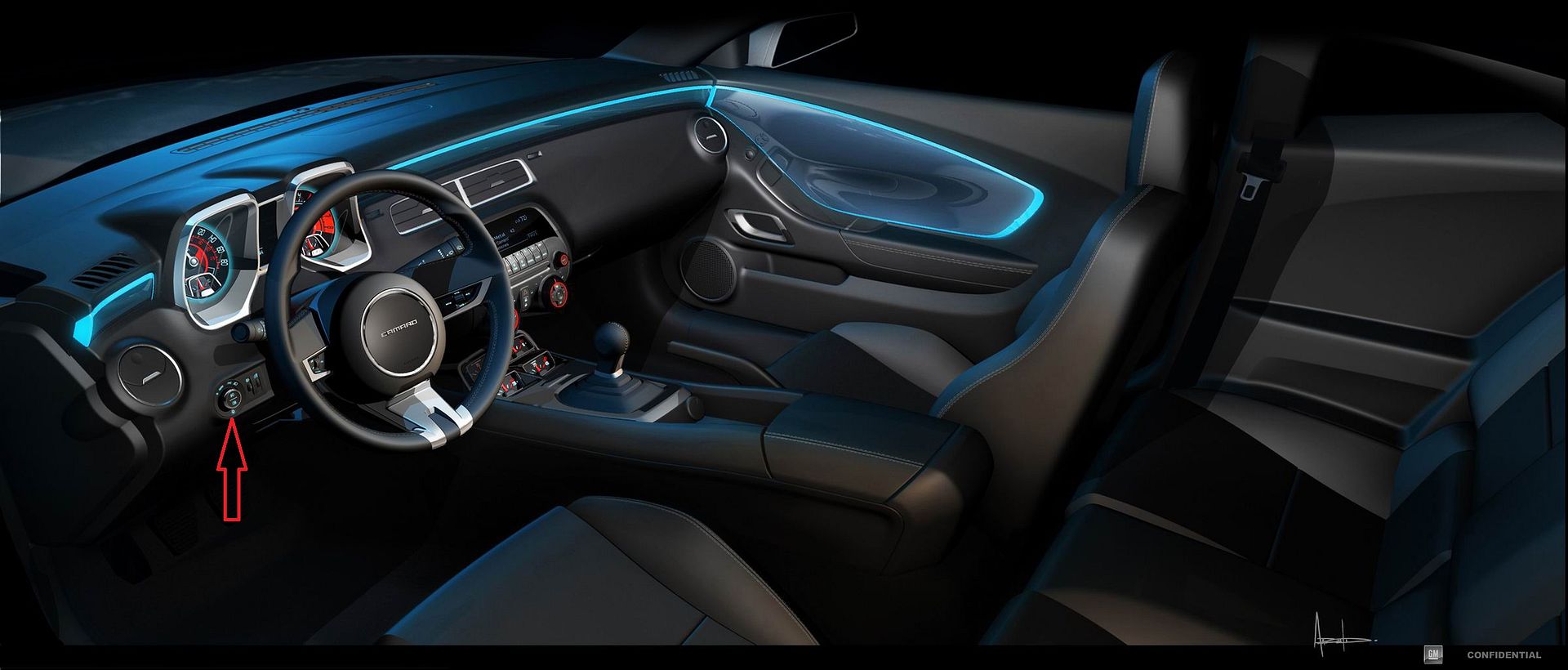

Originally Posted by patternpilot View Post
Sorry for taking so long to reply. I am pretty sure I bought them from APEX.
I have been having the dead battery problem though. No show mode hooked up. My question to those who wire them to another switched power source, do your emergency flashers still function with no power to the lights? I am currently using a battery tender to keep the battery charged, but would entertain rewiring them if it makes the problem go away but keep the emergency functions.
I am happy to check this out for you tonight when I get home from work. The workaround would be to just turn the headlight knob to turn on the parking lights, and this will allow the taillights to function normally, with or without a key.

Originally Posted by AKA-22 View Post
work only when key is on...will not work when key is off..
Not exactly true, you can turn the headlight switch on and they will work without a key. Without a key and the headlight knob turned on, they won't work.

Originally Posted by Normagene View Post
Huh???
Sent from my iPad using Tapatalk
If you turn the knob on the dash (shown in the pic) to turn on the parking lights or headlights manually, the taillights will function normally without the key.
Just messing with you. I understood the first sentence, it was the second sentence that I was applying the "huh".
Ahh, gotcha. Yeah, I guess after rereading I can see how it could be confusing! That's why I included a picture in my response!! Hope you're doing well!
