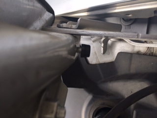

Posts: 17
Chirping noise solved!
Finally figured out the culprit of the strange chirping noise. A friend let me borrow a stethoscope and drove around placing it all around the dash, glovebox, a-pillar, and side panels and no luck on pinpointing the sound. So it had to be coming from under the hood. After 20 min of checking out the engine, i looked at the hood screws and saw that on the passenger side there was this black plastic thing covering an elongated screw but there was no black plastic cover on the drivers side elongated screw. took off the plastic covering and placed it on the drivers side and PRESTO, the noise was gone!!! Funny how such a little thing can create such a god awful noise. Now i just got to find another plastic covering to cover up the passenger side screw
steverino56 is offline   Reply With Quote
