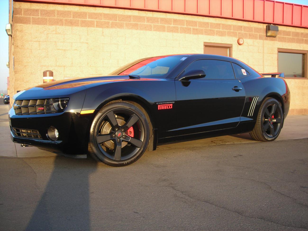

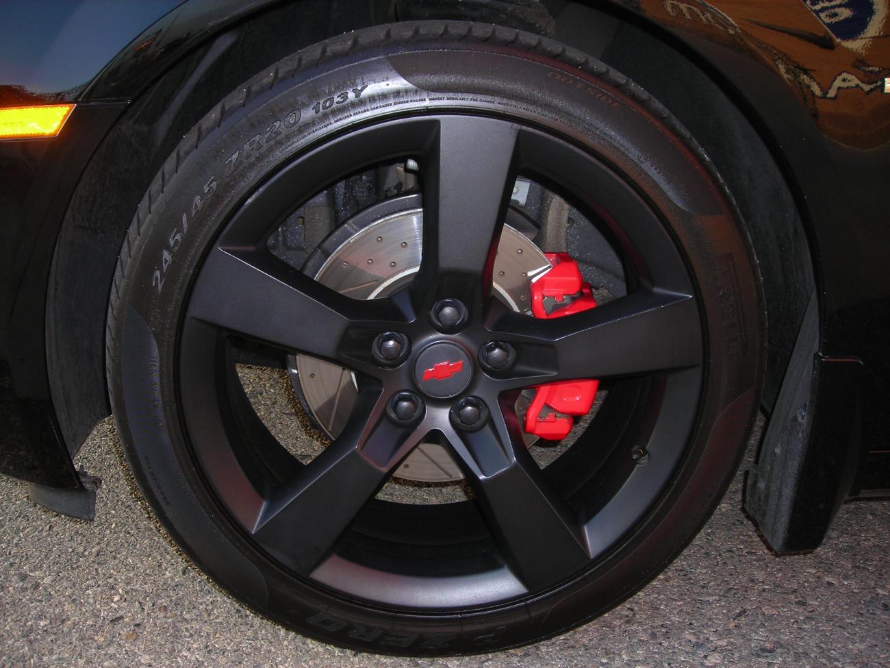

Originally Posted by cornerspeed92 View Post
I did it to mine right away.If that's something you want then do it They look cool,and you will smile everyday you look at them.I would of done it to my 1LE,but i want to get her paid for before i start doing stuff.I went with the Baer decelerators as well.
Car looks awesome, really nice pictures you posted. Did you Plasti dip your rims? Love that spoiler!
