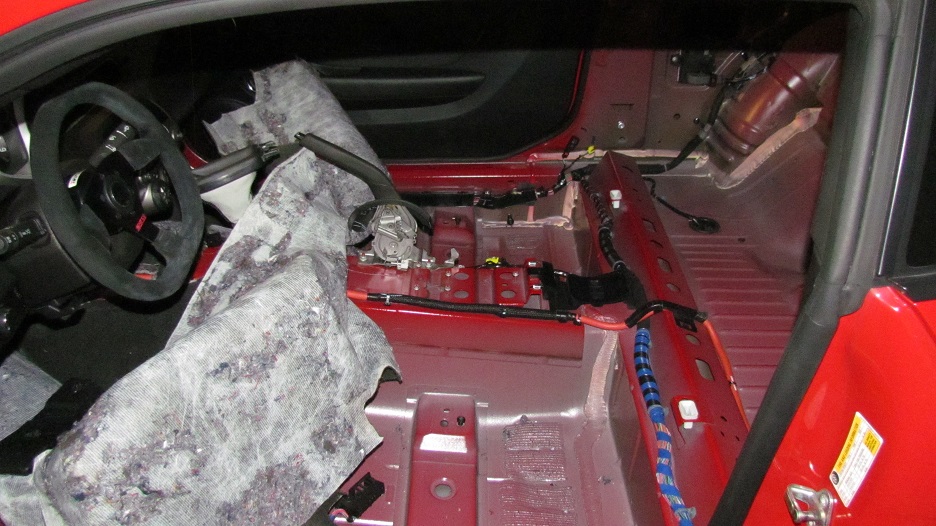

well, its in the car and im taking a break to post some pics. ill eat something and i may do a little more later. i just have it set in there. ill have to scrape all the goo off in places and it looks like ill have to take off the sub frame connectors and tunnel brace. the tunnel brace only because it shares bolts with the sub frame connectors. i was wondering if i could shed the sub frame connector with the cage in there. in other words is the car equally as stiff with the cage only as it is with the cage and the sub frame connectors?

As for the subframe connector, you will want to reinstall it. It's main job is to isolate and control movement of the rear cradle. Something the rollbar will not do.
