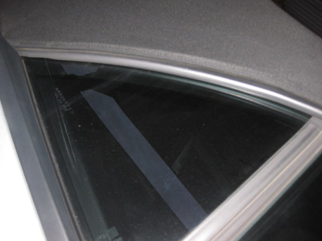

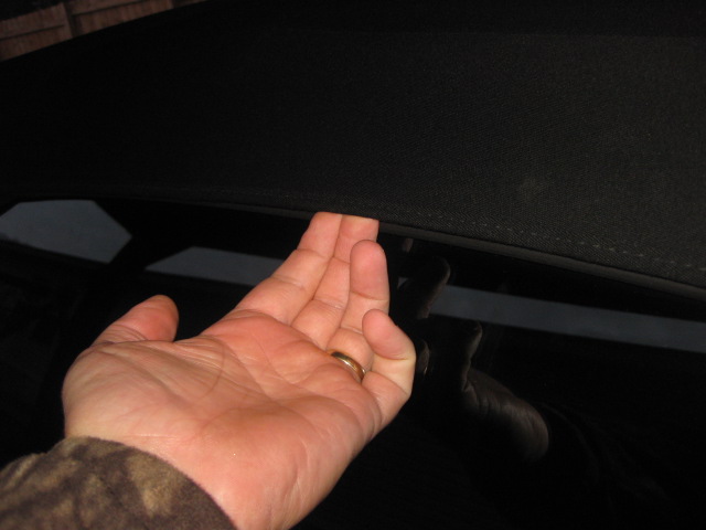

I'm not sure they would have to even touch the cable tensioners to replace the 5th bow, but if they do they should still be snug along the edges just above the door windows and from previous posts the cable should not be visible, especially by the side rear windows. ToddB would know for sure, being he's replaced his.
On the cable tensioners, you can slid your finders just under the edge of the seam and they should be snug. If they're broken or not routed correctly you'll be able to easily slid you fingers under the edges. You would also notice windnoise with air getting under it, similar to having the window cracked open.

No they do not have to touch the cable tensioners. if they don't get the water bag drains on the sides attached correctly your floor boards by the passenger seat will get soaked. Run water over the back with a garden hose for a few minutes and check the floor. The drains are hard the get attached correctly. you can actually feel from the sides of the car to see if they are in correct. But you wouldn't know unless you did it once. The drains that are hard to attach are located on the front side of the water bag on each side of the car.
