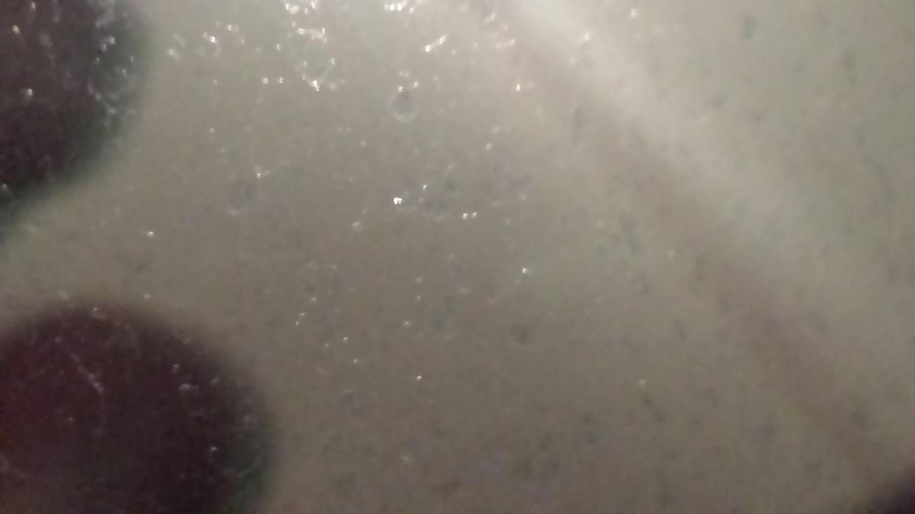

Was also hoping for a little advise from you real detailers out there. My old house had VERY bad hard water. I've gotten it all off the paint finally, but the windows are giving me a hard time. I'd think they would be easier.
What would you guys use to get these spots off? I was thinking a harsh compound with a wool pad on machine polisher. I've zoomed way in so they show up.

Try Claying first before anything else. Use Adams Glass cleaner for the clay lube.

i'll try that, thanks.

Claying, then white vinegar then polishing for the glass.

Was hoping you'd chime in, THANKS!

And also about windows. You can polish those but you will need a special paper thin pad to do it.
Larry at AMMO nyc has the best glass cleaning video I know of so here you go. I have used this process on atleast 20 clients cars as well as my own many times.
http://youtu.be/q4WwOrkgXlc

Thanks for this!
