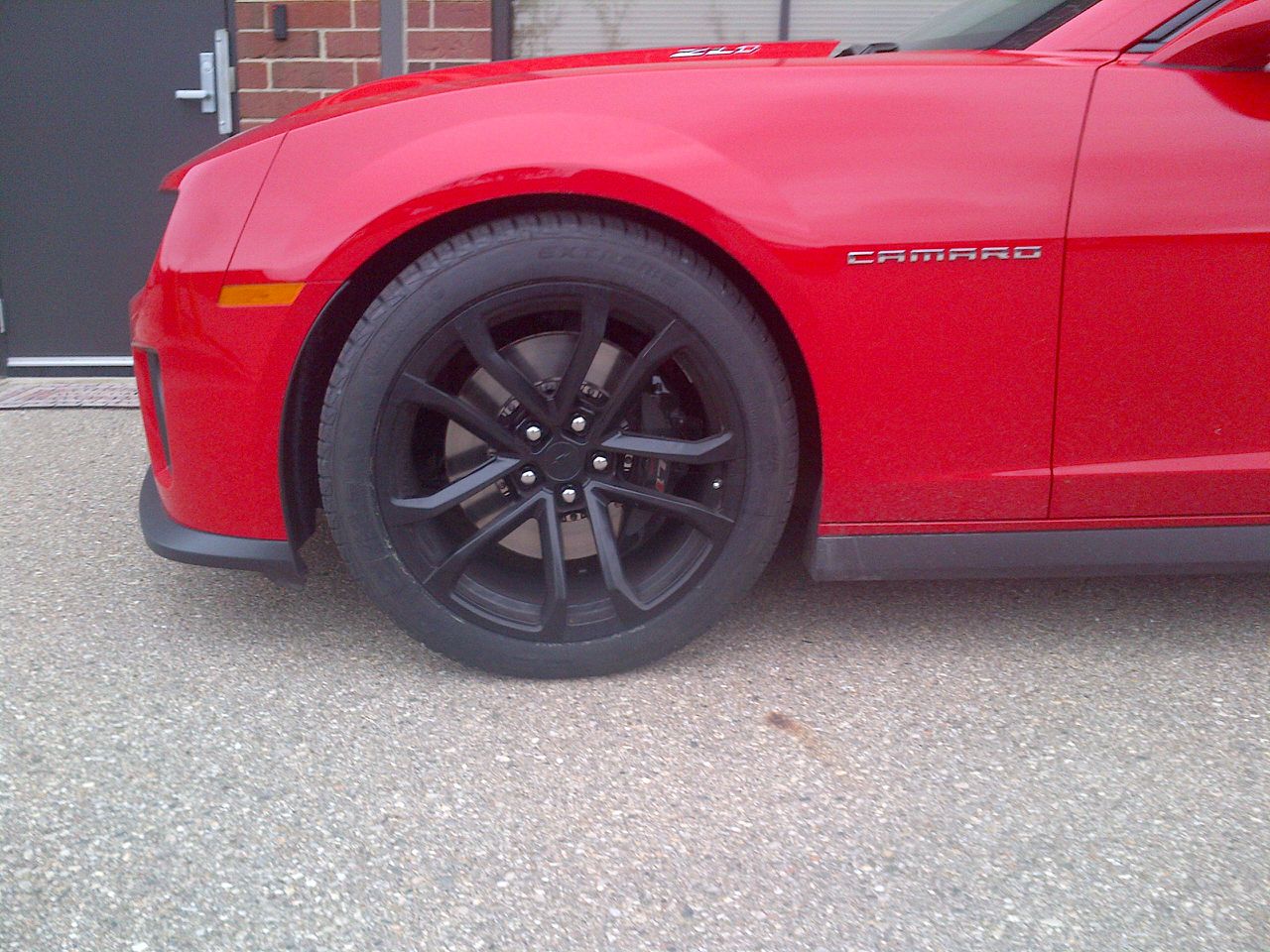

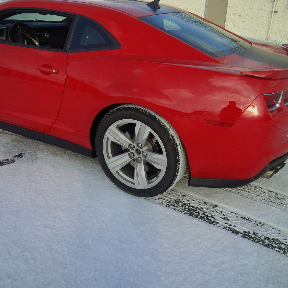

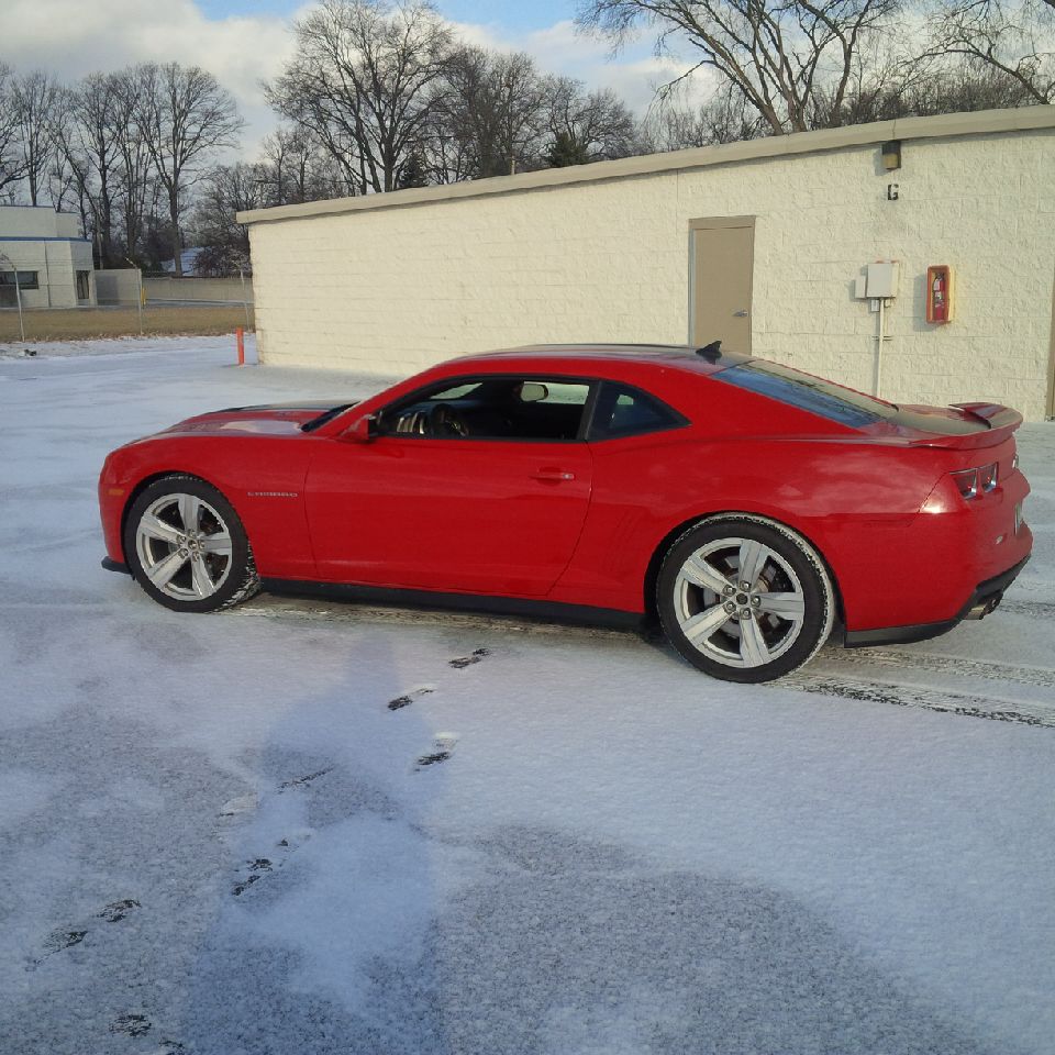

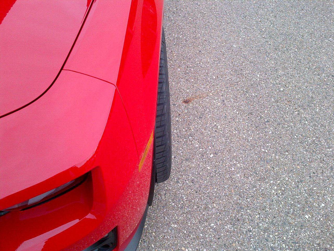

Running 275/40 315/35 as winter setup. Lowered on pedders. No clearance issues.

I have the Conti DWS. As mentioned I drive them only in winter.
Front 1.3" Rear 1.5" drop. Unfortunately I don't have any pics after the drop.
Here before:
