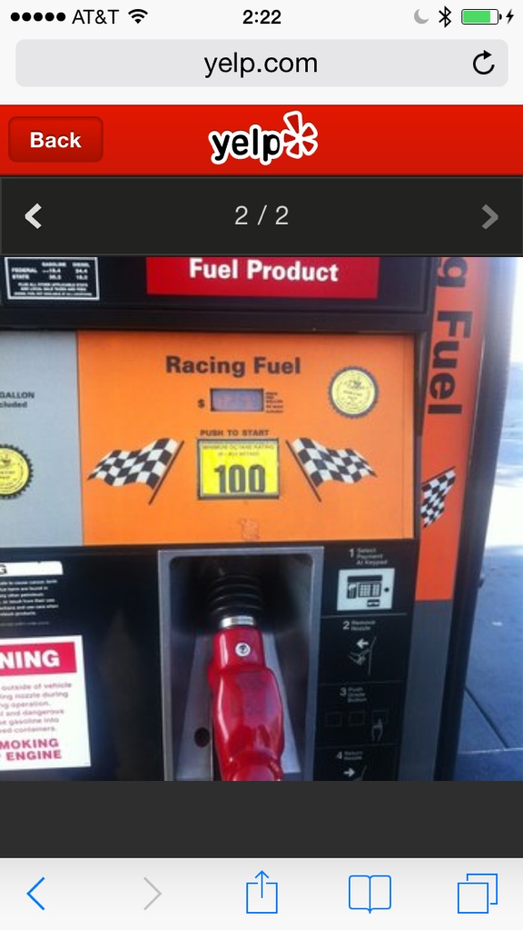

You can get race fuel in San Jose off the almaden expressway.
http://maps.google.com/maps?q=76+Gas...7,-121.8793838
Attachment 631217
That still a little over an hour away from me. What is the price per gallon right now for the racing fuel?
