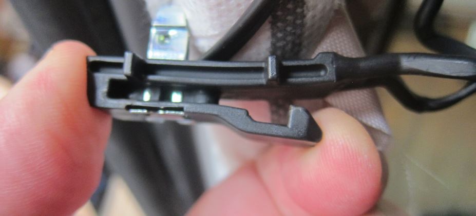

Originally Posted by Rcfiddy1 View Post
Yes, you'll notice on the newer clip the part that will actually goes in the a pillar is now metal with a better mechanism that will hold the tab that slides into pod almost like a spring clip. Also the part on the pod is metal and don't wear out. So when you snap it onto the a pillar it will actually pop into pace. Here is a photo I shot showing the tabs I'm speaking of. Notice I also flocked my guage pod. Hope this makes sense.
This is the tab I have still giving me problems.

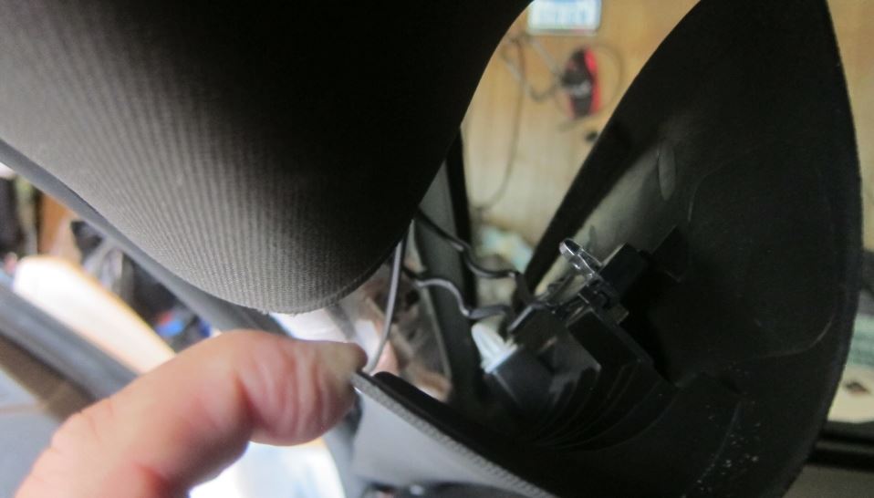

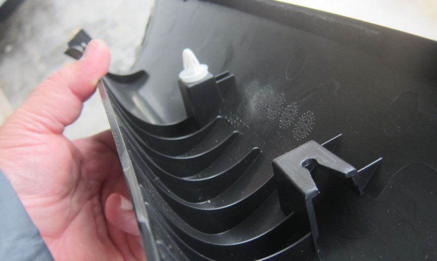

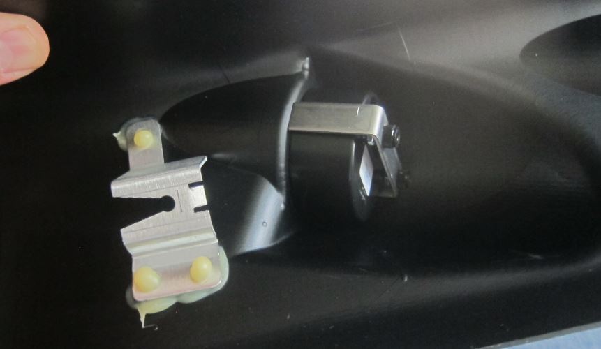

Some pics in case anyone wants them for reference
