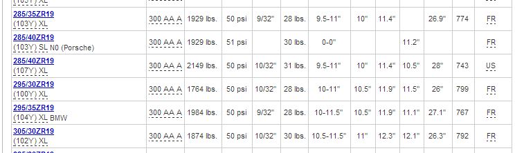

Pilot Super Sports for everything!!!!
In your rim size go for the Z's size, 305/30/19.
(From Tire Rack's website)
T.
