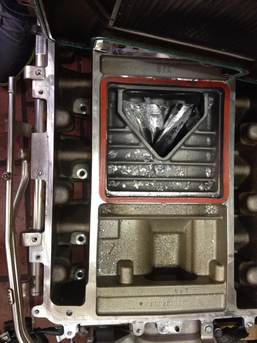

Here is what happens. If you don't stop driving the car when you hear the noise. I heard about the service bulletin 10 minutes after this happened. Waiting on the new engine to be shipped to Germany.
The damage in this photo looks like more than just an isolator issue.
