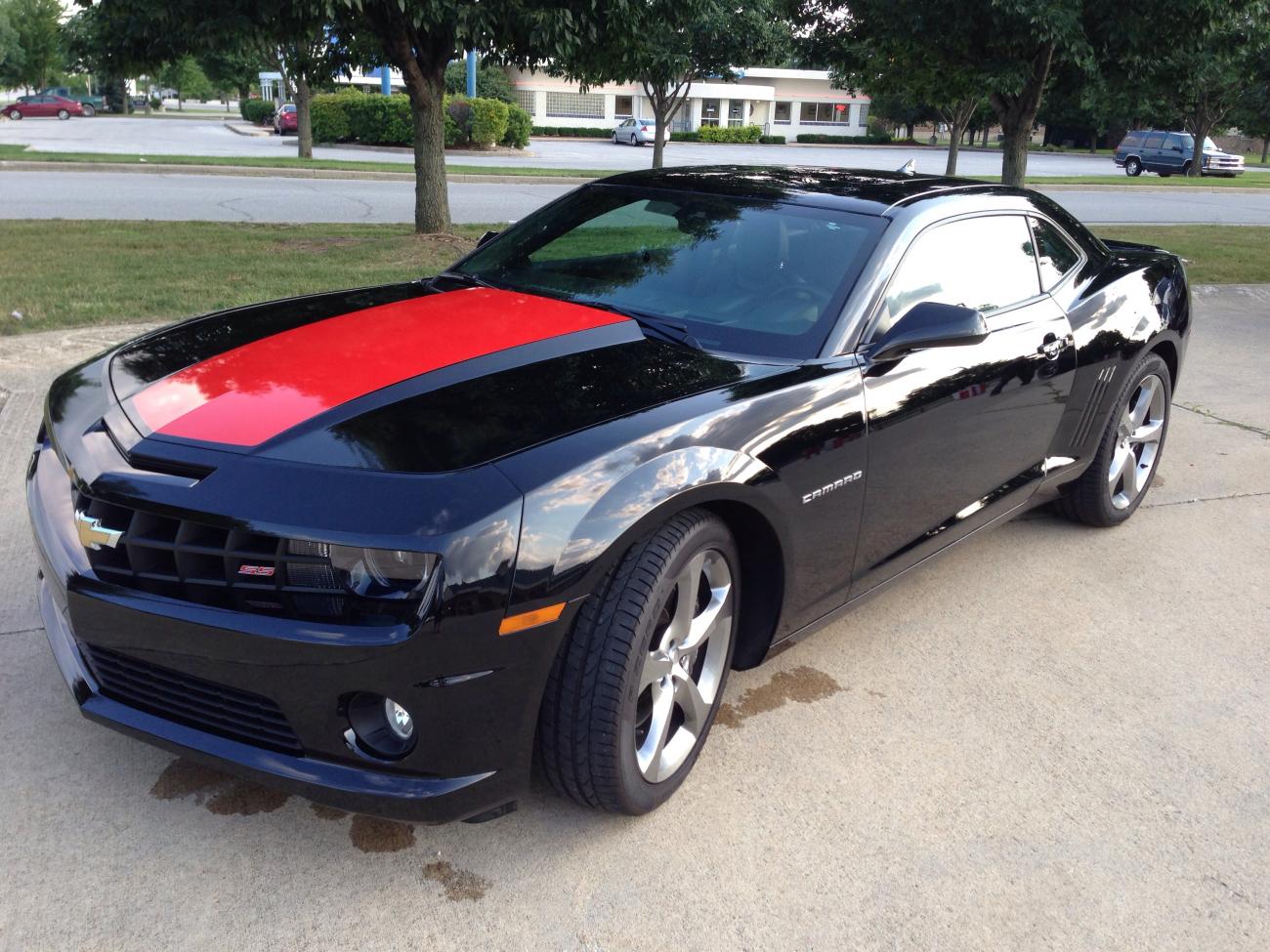

Absolutely love this car, sorry I ranted earlier. She got washed tonight and applied a coat of chemical guys "Blacklight radiant finish." Great product and recommended. Thanks again guys.
